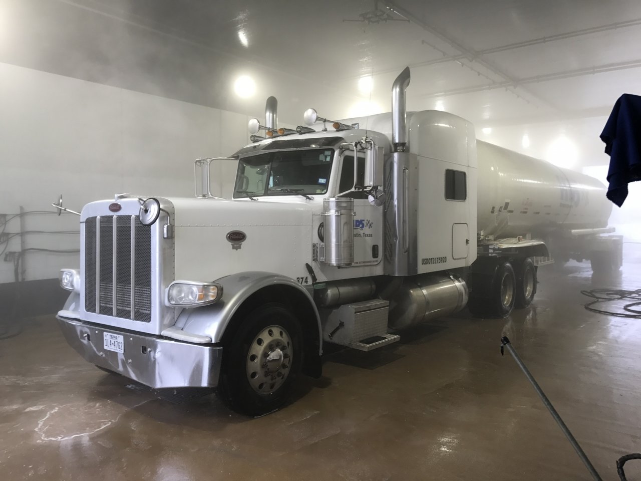

    Oh, quit showing off,,:eek:, I can't think of a single useful purpose for a long hood, other than looks. They are harder to get around, almost impossible to get any weight on the steer, and are best with a reefer behind them out in the desert, neither of which I'd ever do again. I think people find that stuff out the hard way,,a 1/4 million bucks in,,.
