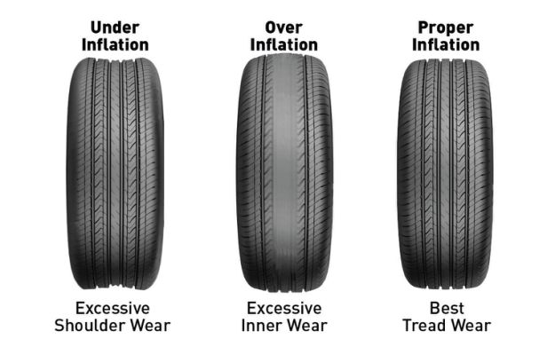

    Pretrip !!
    That is a heat damage issue from underinflation, sluffing the centers off from flex.... Usually less than 90 psi..... You see this allot in tires that have been ran flat and damaged.
    I'm very familiar with those drives and just by looking at them it's probably under 80 psi if not almost flat.
    Long term, those casings are junk they're highly likely to have a blowout now.

    The inner edges are slanted too...this I can see often... is that a part of under inflation or alignment? Could it be also bearings?

    Close but on spinning & gravel use, you will see matching patterns on tires across the whole axle.. it can present sightly more on inners but if you look at the other tires you'll see the problem tires are isolated mostly.
    There can be a combination though, as the tread block on new tires is very high it is also susceptible to the most amount of flex and actually can run hotter. Usually seeing this type of damage means that the tread temperature has been 160 F or higher.
    The inside tires are the most susceptible to heat and if it is underinflated that's even worse to produce heat.
    Pressure pressure pressure needed to stay cool guys
    The difference between 100psi and 120psi on 90F+ days is about 20° , plenty to put you at the danger zone of 160°F(+) especially if loaded heavy or driving 65+ mph.
    If you wanna watch this buy a laser temp gun and track the tread temps on hot days, you'll see a big reduction in temperature using higher cold inflation pressures.
    This correlation between temperature and pressure is hyper critical on Super Singles loaded heavy in summer heat. They must be 120 psi nothing less.
    If you use 120(cold) on regular duals it drops tread temps significantly.

    Looking at the pictures again, you can see how both the inner rear tires have the most damage. I’m starting to think it may even be the rear axle shocks. A PSI check on his tires in cold state would also help in finding the problem. I honestly don’t see how it could be under-inflation as the center wear is attributed to over-inflation. Maybe I’m missing something.
