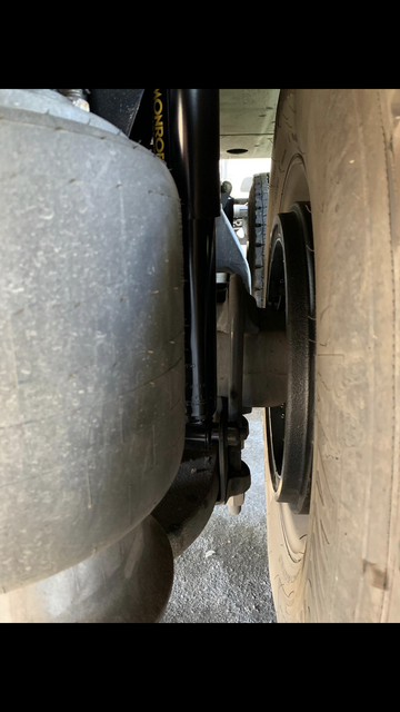

    Well guys, I got all new monroe shocks on back (4) , tire rotation, and other things that needed to be done - all new oem brake drums and brake shoes on the back all 4 of them , and my heater core was leaking replaced those, hit the bank with a 2200 bill, will get a alignment soon, will keep you guys updated, on what happens and if it worked out

    Did you ever reset the psi in the tires? If so what to?

    It currently had 105 all around, if you guys think that’s less or ... let me know

    gravel roads can do that to tires.

    Theres no chance your power divider is stuck locked in is there?
