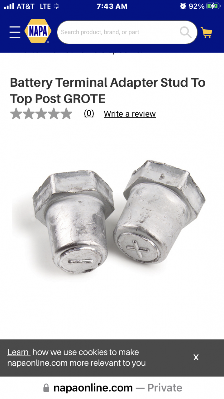

    What do you do about the stud post?
  8. RedForeman
    RedForeman Momentum Conservationist
    4,875
    22,141
    Jan 30, 2011
    Put a stud terminal on the cables? Or, if you're lazy, lead post screw-on adapters are available.

  9. SmallPackage
    5,512
    17,570
    Dec 20, 2019
    Marion Texas
    A screw on post adapters.
