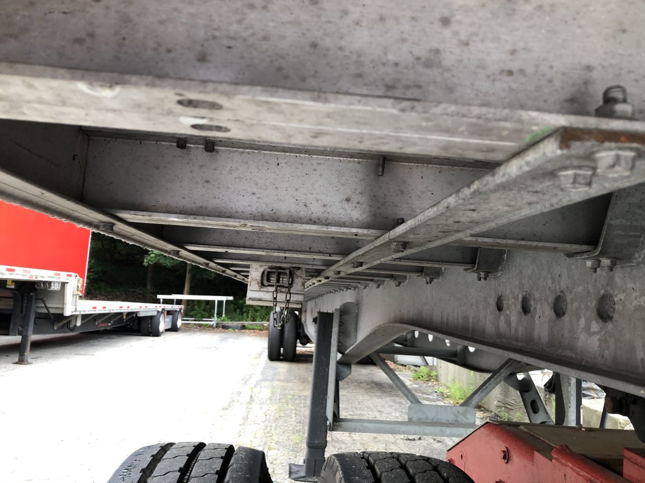

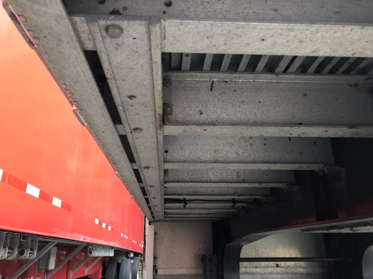

    this is the tie bar on one of the transcrafts i ordered a few years back.

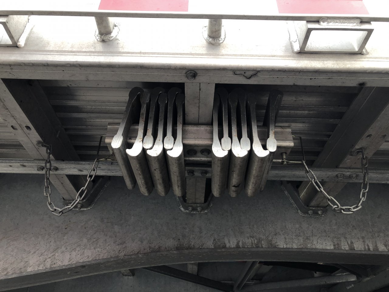

    This is the tie bar on the new manac i bought last year end; see where the j hook storage is?
    If you run a flat hook to the tie bar where the j hooks are stored.......
    I’m not an engineer, I would’ve thought running the J hooks on the inside and the tie bar on the outside would make more sense.
    blairandgretchen, Tug Toy and cke Thank this.

    I'm guessing by the open holes in the cross frames that in the absence of the J-hook holder, the tie bar would be on the outside? Or someone just got it wrong?

    I really don’t know, but when bolting it together, it would’ve been easy enough just to put the J hooks inboard of the tie bar. Chances are, i want one and not the other For the most part.
    All the other units that were on the lot that day were set up the same way. So I can’t speak to it being a mistake versus a common place thing.
    I guess I will find out quick enough though, I ordered another new step deck. Should’ve actually been here last week. That does not have a J hook system. So I’ll see how it’s set up when it gets here.

    like not4hire said it looks like the holes are already there closer to the outside rail. Can you swap them, move the tie down bar outward and move the J-hook storage inboard? They appear to have the same holes.

    Strapping to the rub rail is better imo.
    If the strap get’s loose it won’t fly away, like it would when strapped to the tie bar.
    I’d rather have a loose strap flapping on the load (that I can stop and re-tighten), than a ribbon flying straight into my axles.
