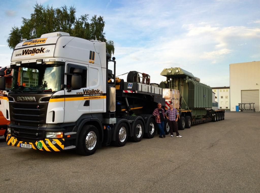

    here is r730 8x4 from wallek from münich, driver is serbian i am quite good with his grandson (who gave me picture), it is hooked to scheuerle/nicolas formula7 trailer with 2+5 axles trailer is 26250kg empty, it is pretty interesting because of very specific neck , it saves about 2400kg comparing to normal solutions, also because as you can see trailer also have additional 2 axles in front, they weight 6.12t
    all together max legal weight is 143t , scania is 11900kg empty, all together payload 98730kg
