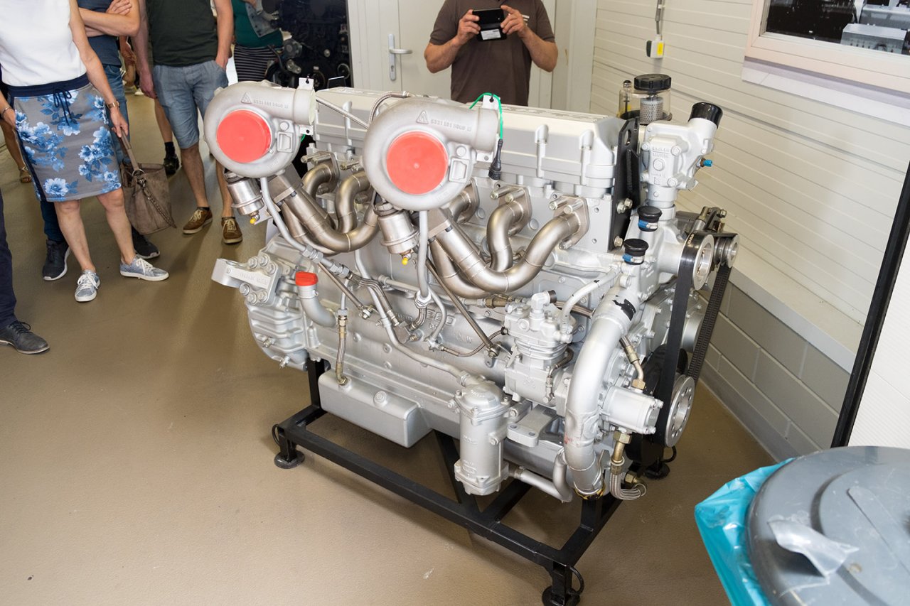

    Go-karts? Yard dog?

    Sorry, but as far as I can see, it is not an MX.....Looks more like an XF or XE engine.
    BTW, 1500 hp is not that special for a racing engine.
    Plenty of 5.9 B-series Cummins engines out there that do better than that.
    Or International DT-series over 3000 bhp.
