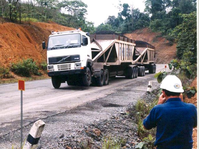

    that is too worst thing i have seen
    some facts,
    Trucks in use 24/7 trips between
    Gross weights up to 250tonnes 550 000lbs ( depending on load, and trailers but no truck have under 175 tonnes 386 000lbs)
    Legal axle weight 44 000lbs 20tonnes
    Temps 110F are not unusual 43C
    High humidity , nearly 100%
    Lot of rains
    Lot of mud
    even 12% hills
    Usual math is like, 45km 28mille in one direction, 10trips per day, cca 320 000km per year, cca 200 000milles, they keep trucks for 10years,that is 2million milles or 3.2mil km
    That is only place where Volvo dont force its i-shift
    Imagine how much strain take that driveline, if axle loaded with 10tonnes/22 000 lbs lift like that
