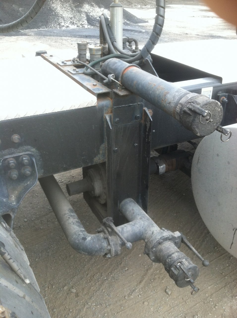

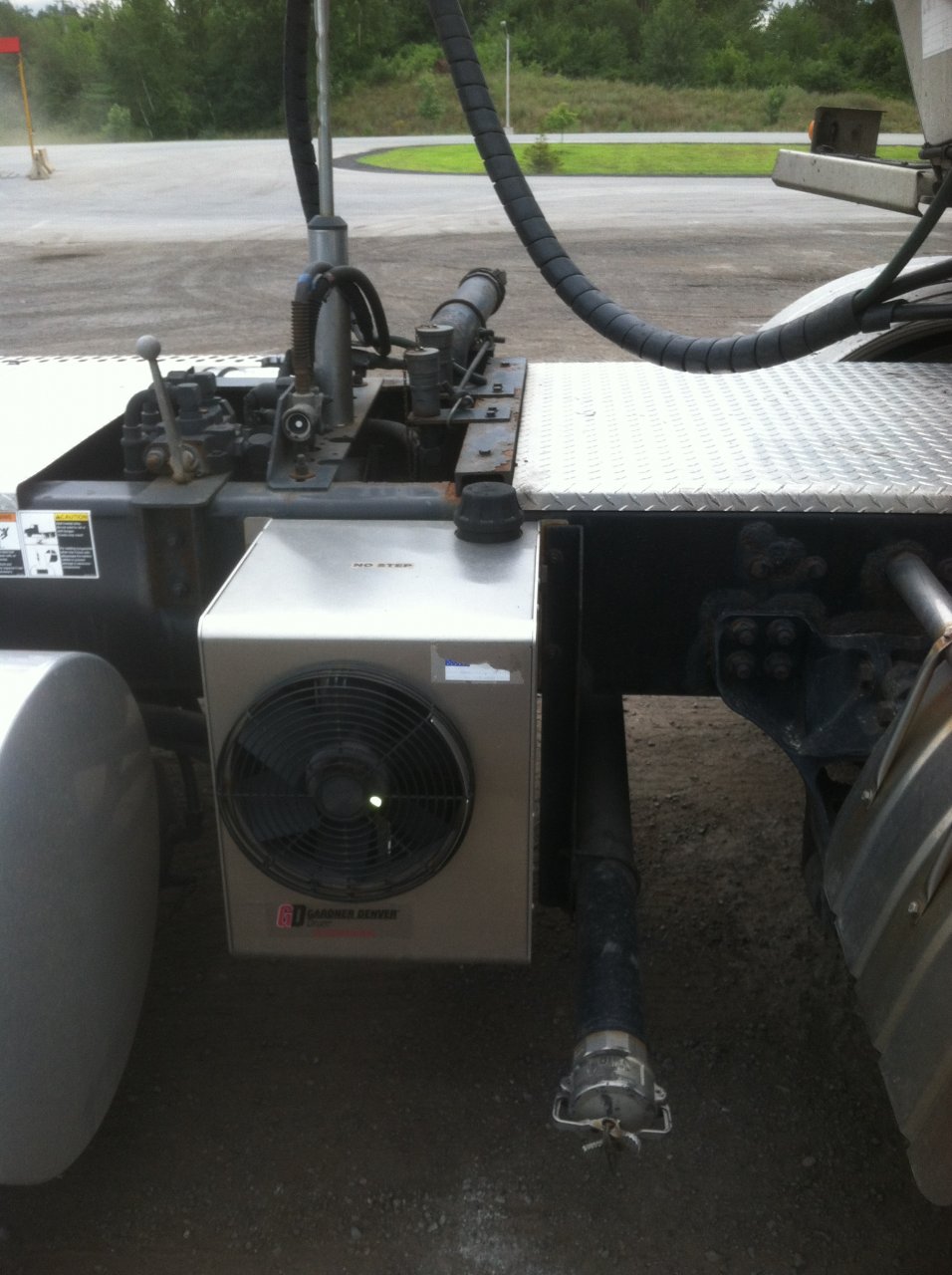

    Always wanted to set-up a hydra-pack, but they are not big enough to run our GD CDL9 blowers. Did a " home-made" hydra-pack for a Peterbilt glider. Used a dump pump for a set-up that could pull a bucket, run a jack-shaft for ammonia tank, and run compressor for acid. Think I went through a whole can of pipe dope!
