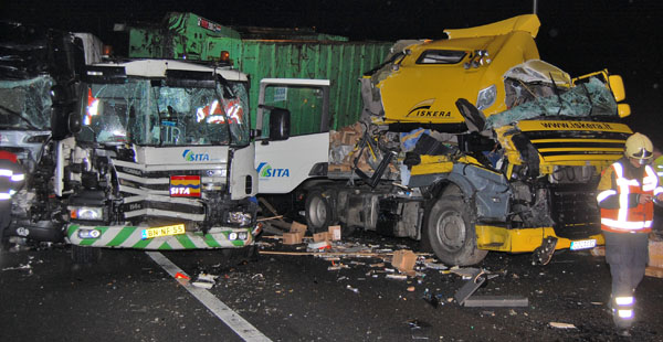

    Very unlikely. A car will hit the engine block of a COE, below the space where the driver is. It may dislocate the cab, but the cab is designed to be dislocated in such an event.
    Look at these pictures of a collision that involved 5 trucks, some vans and passenger cars:
    Was the driver of this truck killed? No, according to the news message one truck driver had minor injuries and could be treated at the spot.

    I agree with you, that could be the weak spot of a conventional. I get the impression that the engine is mounted higher in a conventional frame, compared with a 'real' COE frame. So with a COE, engine block (below the driver space) and cab work together to withstand the collision. With a conventional the engine block is in front of the cab, and it is pushed inside the cab where the driver is.
