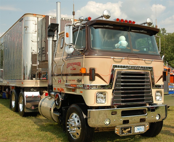

    I don't think any of the european (or american, maybe the GMC Astro is closest in that respect) trucks of that era had the same rounded cab corners specially when looking at windscreen level. Lower cab corners of european cabs were rounded, but much smaller radius.
    Higher up (windscreen level) they were quite angular.
    If you compare the pictures below, you will see the difference.
    The gap between cab and trailer is indeed an aerodynamic nightmare.
    Typical North American fleet trucks with high trailers use cab extenders and high roof cab or high deflector as well, but with the shorter kingpin settings as used in North America it is not possible to get the trailer as close to the cab as with the european king pin settings.
    With shorter king pin setting the difference between king pin setting and radius of front trailer corner is bigger than with long king pin setting.
    When turning, the corners of the trailer will hit the cab much faster with short king pin setting (when trying to get the shortest cab-trailer distance when straight)
    For example (assuming 100" trailer width for ease of calculation):
    King pin setting of 63", the radius of the front corners to king pin is 80.5 inches, so (in theory) you only need a back of cab - trailer gap of 17.5", to avoid hitting the cab with corner of trailer when turning.
    King pin setting of 36", the radius of front corner to KP is 62", so you need a gap of 26".
    King pin @ 18", radius is 53", so you need a gap of 35"
    Dark blue: back of cab
    Green: trailer
    Black cross: king pin
    Light blue: radius around king pin
    Black vertical lines show difference in (theoretical) minimum back of cab - trailer gap
    Clear to see that gap must be larger with short king pin setting.
