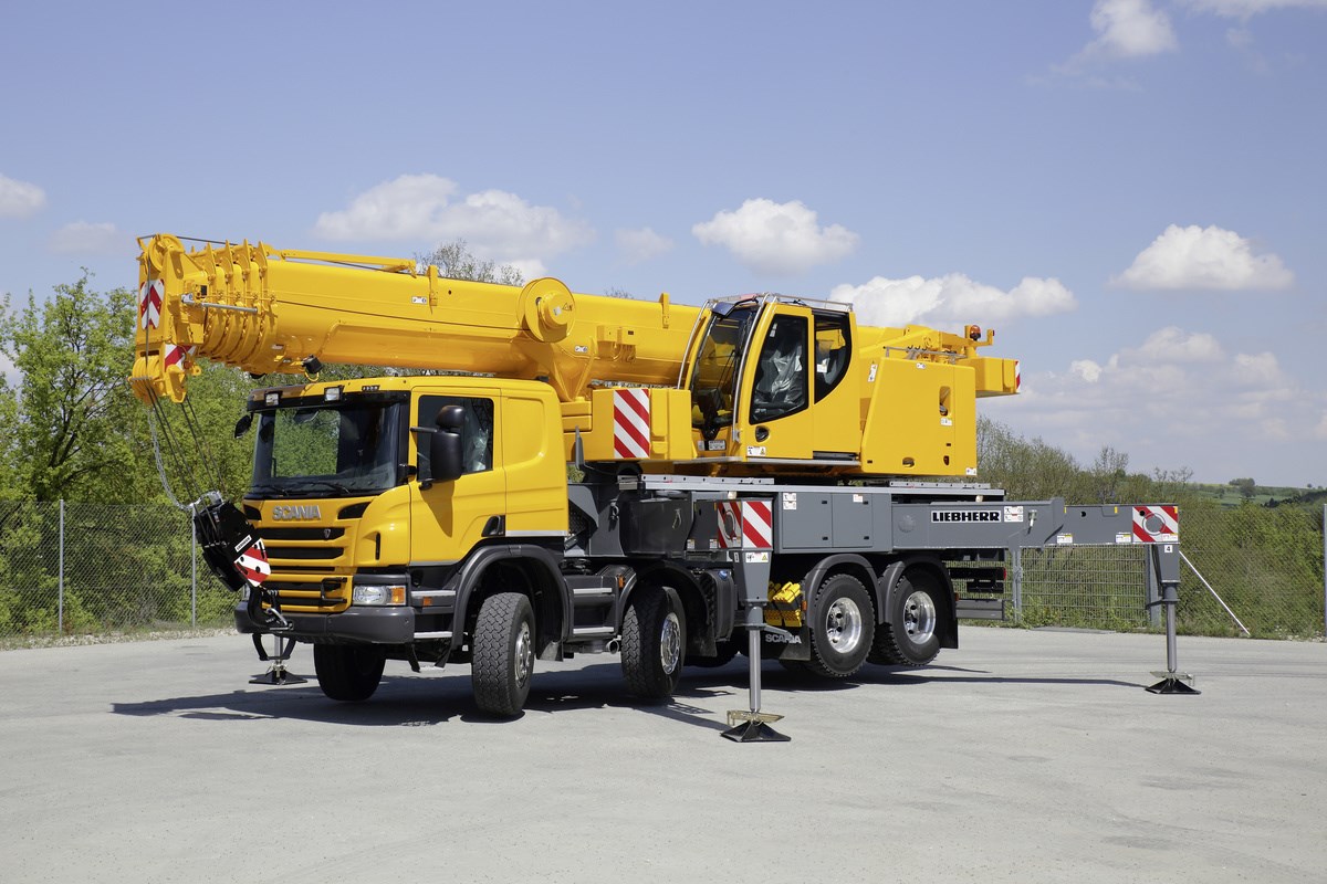

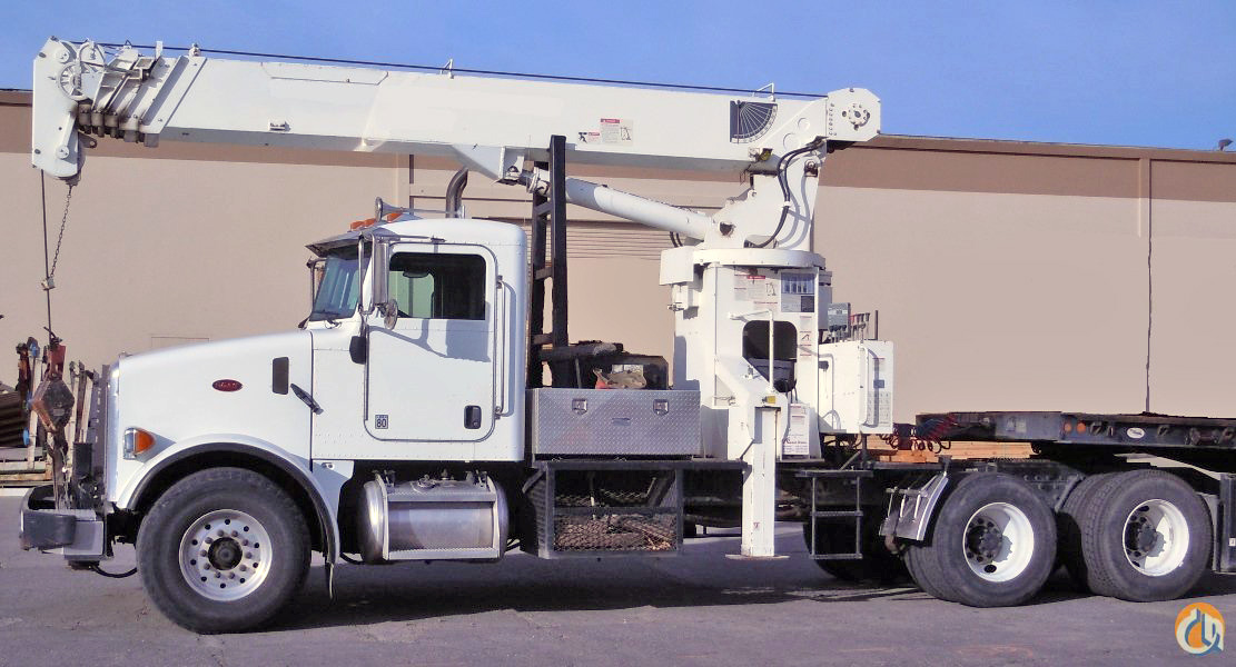

    What I meant with cranes on tractors was the knuckle boom crane on that green Kenworth.
    This type of crane:
    Is unknown here. That makes sense, because it would stick out far too much over the front over a COE truck.
    This is our equivalent of the blue truck with a crane:
    A bit more compact (as usual).
    But most of the time this kind of crane is used in various sizes:

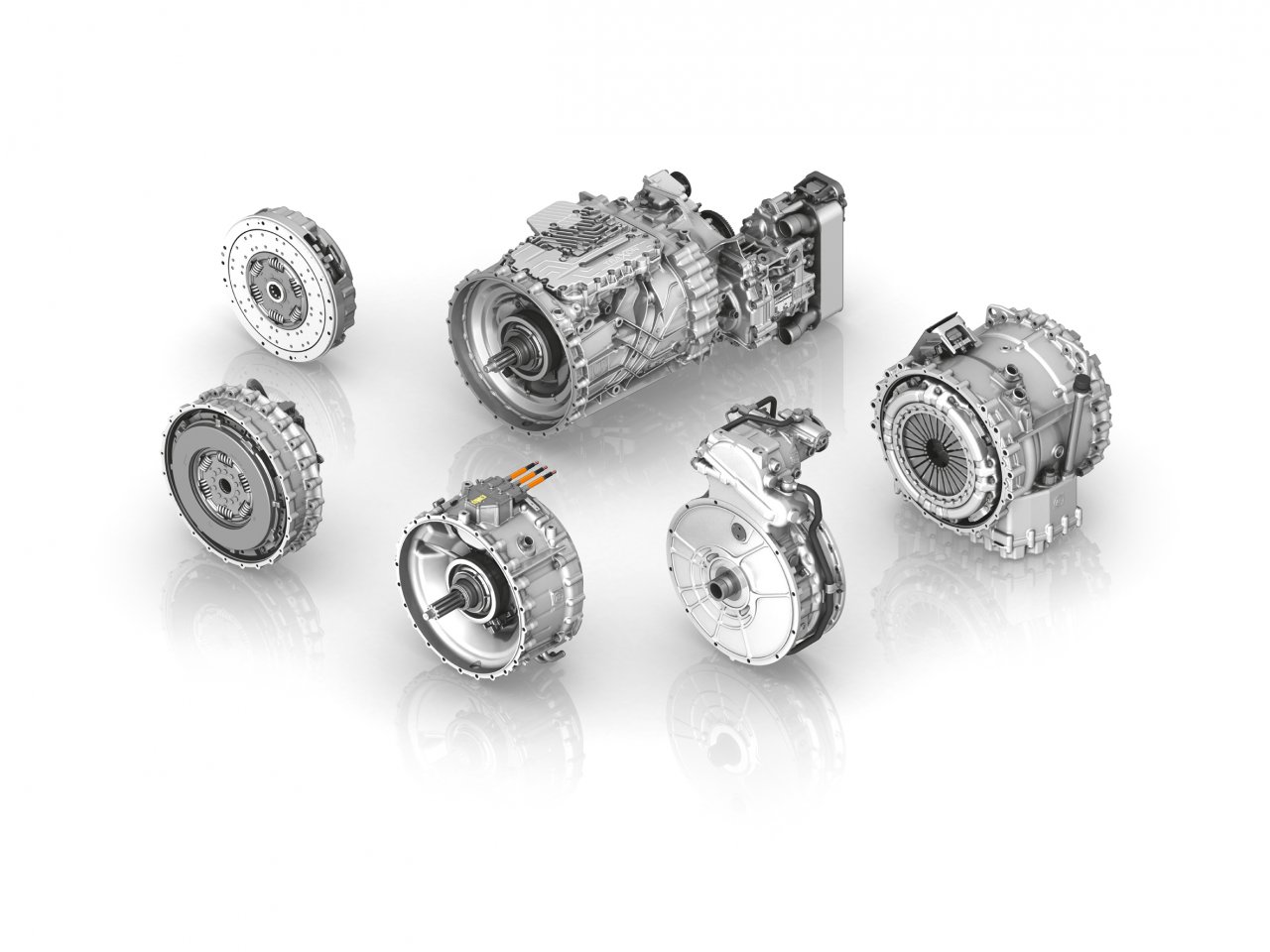

    I get the impression that the AS Tronic is going to be replaced by the Traxon gearbox. It's only available in automatic versions:
    It's a very interesting modular concept. There are 12 and 16 speed versions, a normal one or two plate clutch, a double clutch, a unit for hybrid drive, a unit for direct PTO from the engine, and a torque converter.
