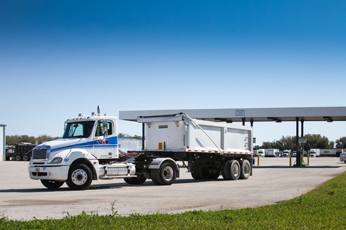

This is a trailer with a 27t (60,000 lbs) payload, and a tarra of 6,6t (14,500 lbs). It is meant for a standard EU semi with a GCW of 40t.
Let's assume it is loaded with concrete blocks. Concrete has a specific mass of 2.4t / m³, so it can load 27/2.4 = 11.25m³ of concrete.
The floor surface is 7.15m x 2.42m = 17.303m²
If the trailer would be loaded with one exact fitting block of concrete, it should be 11.25 / 17.303 = 0.65m (2' 2") high.
Seems to me this trailer is well designed for its apparent purpose.
The distance from the kingpin to the last axle is 5.8m (19 feet).
When we hook it to 4x2 EU tractor, the distance from the rear axle of the truck to the last rear axle of the trailer becomes 5.34m ( 17.5 feet).
So we have a load of 27 + 6.6 = 33.6t or 74,000 lbs on 4 axles over 17,5 feet. In the US that 17,5 feet should be 48 feet in order to comply with the bridge law.
So that trailer should be almost three times as long ....... No wonder you think it's short.Last edited: Nov 21, 2017
