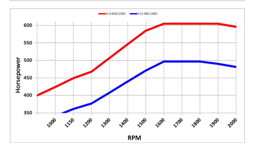

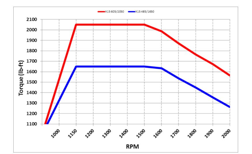

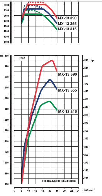

    Both Cummins and DAF graphs of torque and power curves are inaccurate at low rpm's, Cummins below 1100, DAF below 1000 rpm.
    In both cases they have contradictory data.
    Example:
    DAF shows more power for the MX-13 355 than MX-13 390 @ 800 rpm, or just above 800, yet the torque curve shows a higher torque (at this engine speed) for the 390 than for the 355. As you know, this is mathemaically impossible.
    Torque at low rpm (800) for the 315 is clearly lower than 390, yet power shows same level.
    As you know, this is mathematically impossible.
    The Cummins curves are not accurate at low rpm's either.
    At the point where the horizontal axis crosses the vertical, there is no value on the horizontal axis.
    Then at next intersection it says 1000 rpm, next 1150 (150 rpm interval) then 1200 (50 rpm interval), and 1300, 1400 etc (100 rpm intervals)
    Also the Cummins power curve shows 425 hp at 1000 rpm, which can not be true. This corresponds to torque of about 2230 lb-ft. So higher than the maximum of 2050.
    The curves I posted are based on the data that seemed to be accurate.
    I can make up data and put them in a chart, but what is the point?
