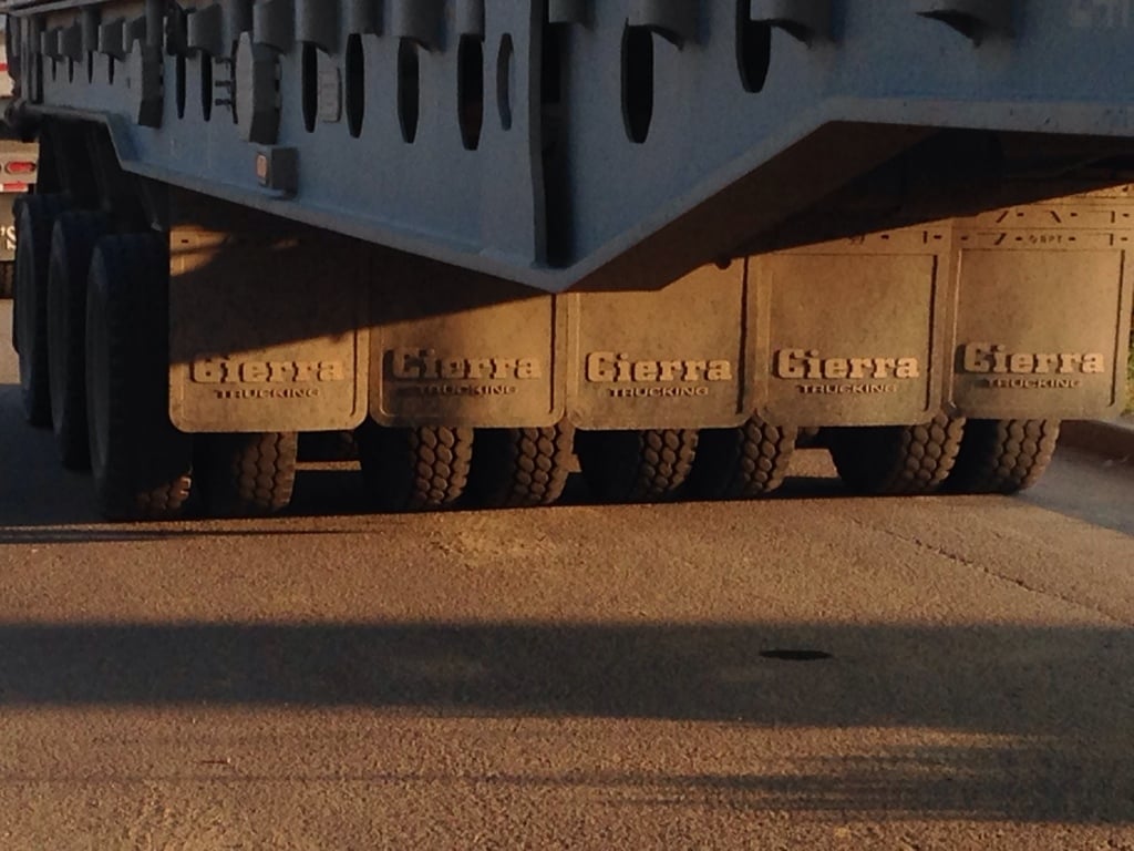

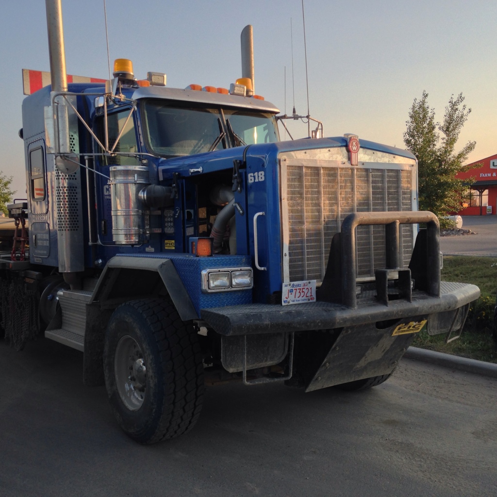

    Parked beside some big iron in Drayton Valley AB.
    C500 Tri drive winch tractor
    Pulling a 24 wheel trailer
