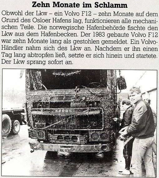

    This 1983 Volvo F12 was stolen, and the Oslo port authorities retrieved the truck after it had been on the bottom of the harbour for 10 months. A dealer let the truck dry a bit for one day, turned the ignition key, and the truck started.
    king Q and Cat sdp Thank this.

    Started on first try and even drove.
    And a picture in color https://www.facebook.com/VolvoTruck...93328.428554310520455/494307080611844/?type=1
    No really that amazing after all. It's not the sea that kills engines. It's if it isn't started directly after it's back on land so the corrosion can start and destroy everything
    Ex. a friend got 2 Volvo D6 marine engines that been under Atlantic sea water for 6 months, full of electronics, compressor + turbo. Drained them from water and new oil. They started perfectly and works fine still today.
