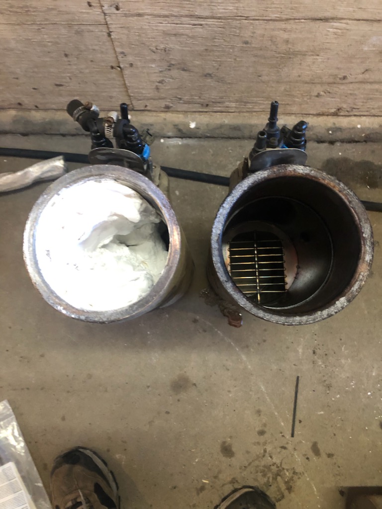

    Kentucky passed laws favoring diesel for a long time.
    Gas was available in ford and gm chassis till about 2003. Gas, propane made a comeback 2010. Epa 2007, and epa 2010 diesels were terrible in school bus applications when they 1st came out. They have improved significantly yet still cause issues.
    Blue bird, freightliner(thomas) and international all offer propane or gas again. School busing is a low bid industry, for some it makes sense. I have 1 run that is primarily highway. That unit is diesel. Here is an Scr can off a 2016 cummins.
