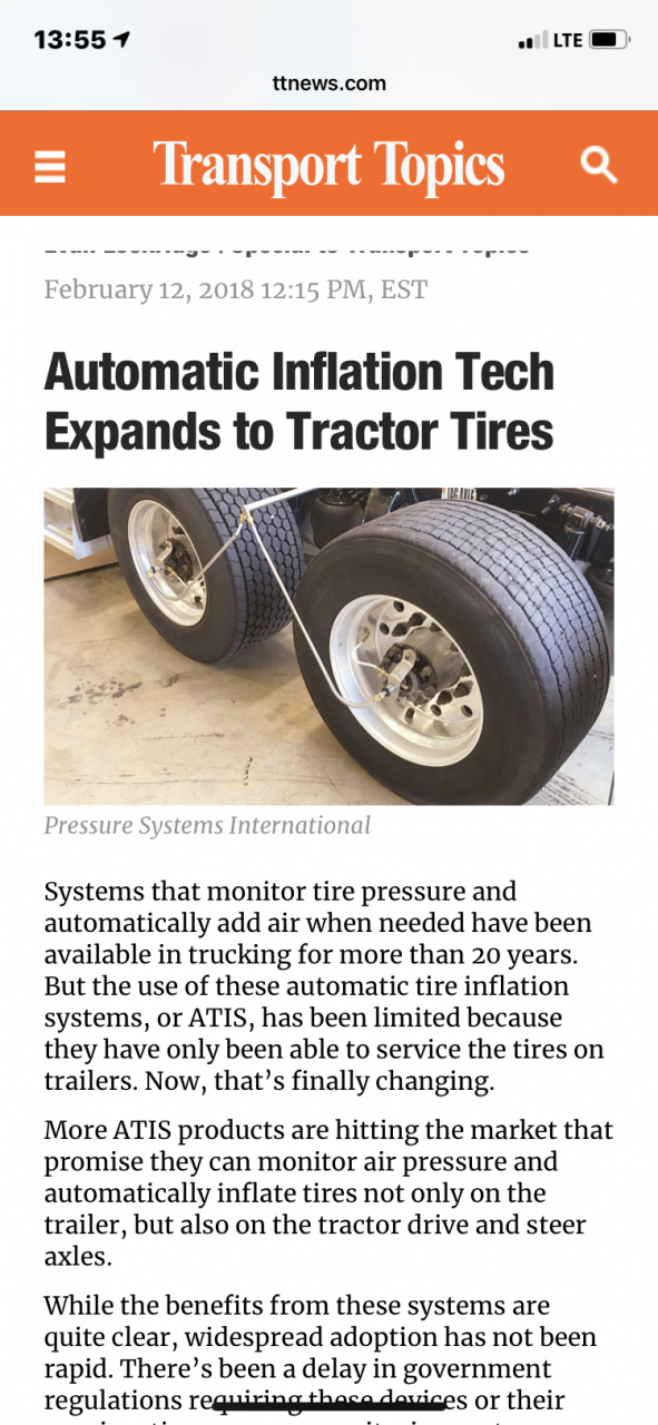

    Still kind of wish trucks had it. I have a very slow leak in one of my drives, too slow for the TA to find and fix. And it's annoying having to pump it up 30 PSI every three weeks.

    I carry a plug kit, they work pretty good to get me down the road.
    Then when convenient I still get it fixed properly at a tire shop.
    Trailer axles are hollow, easier to run the air lines. They do make ones for trucks, but they use lines that are suspended over the tires and drop down to the hub to feed the tires.

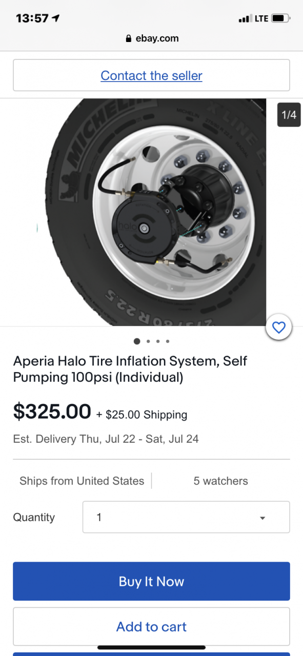

    The units for the trucks are expensive and seal and o ring issues. They look hideous and to easy to break off.
    I am glad I own my equipment.
    Easier to just check my tires daily with a gauge when cold. All of 5 min or less
    They make the halo system which bolts to axle flange.

    Wow. I'm usually not too concerned with how my truck looks as long as it's clean enough to not attract DOT's attention... but boy, those things are sure are ugly
