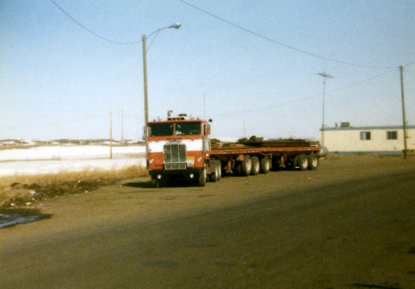

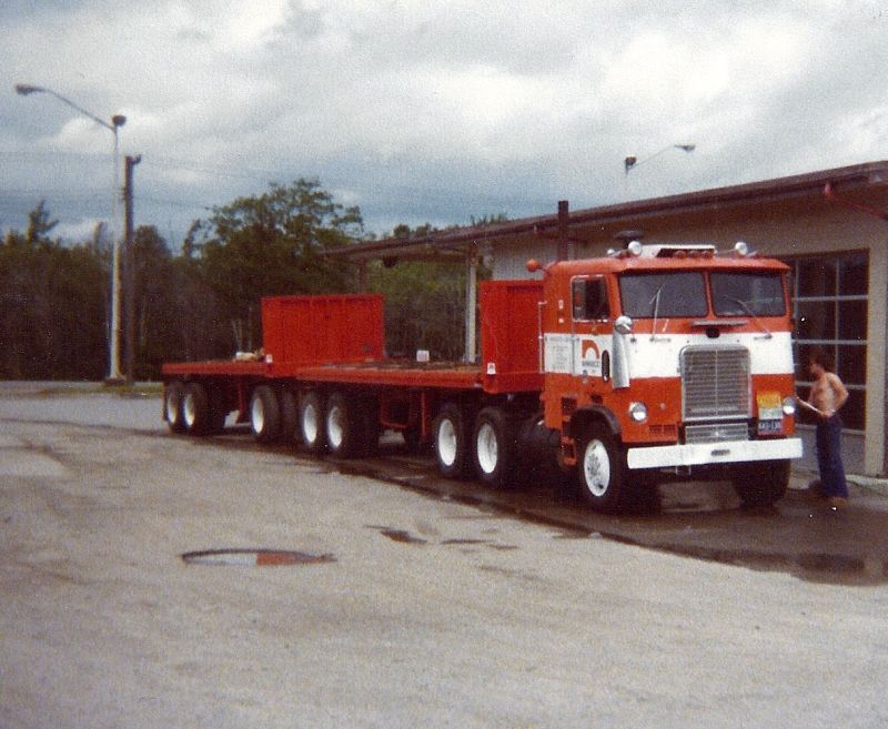

    I am actually lining up equipment to build a rig almost exactly like that red Freightliner, but with double 28's. Finding 28' flats is hard, though. Got a line on a few cabovers of similar vintage. Why? Because it's not going to be my primary gig, I've got a use case to justify monetizing it, and I need a hobby.

    Now, while I'm still here, I have a question about pinning turntables. How can you turn with the turntable on the tail trailer pinned? Or is it more like get the set lined up, pin the turntable, then straight back?
    I'm still stuck on C dollies, I guess...I would really just prefer a B-train but don't think they quite fly in the US's regulatory scheme. C dolly seems as if it would operate very similarly, but still be a "convertor dolly" that can be separated from the set.
