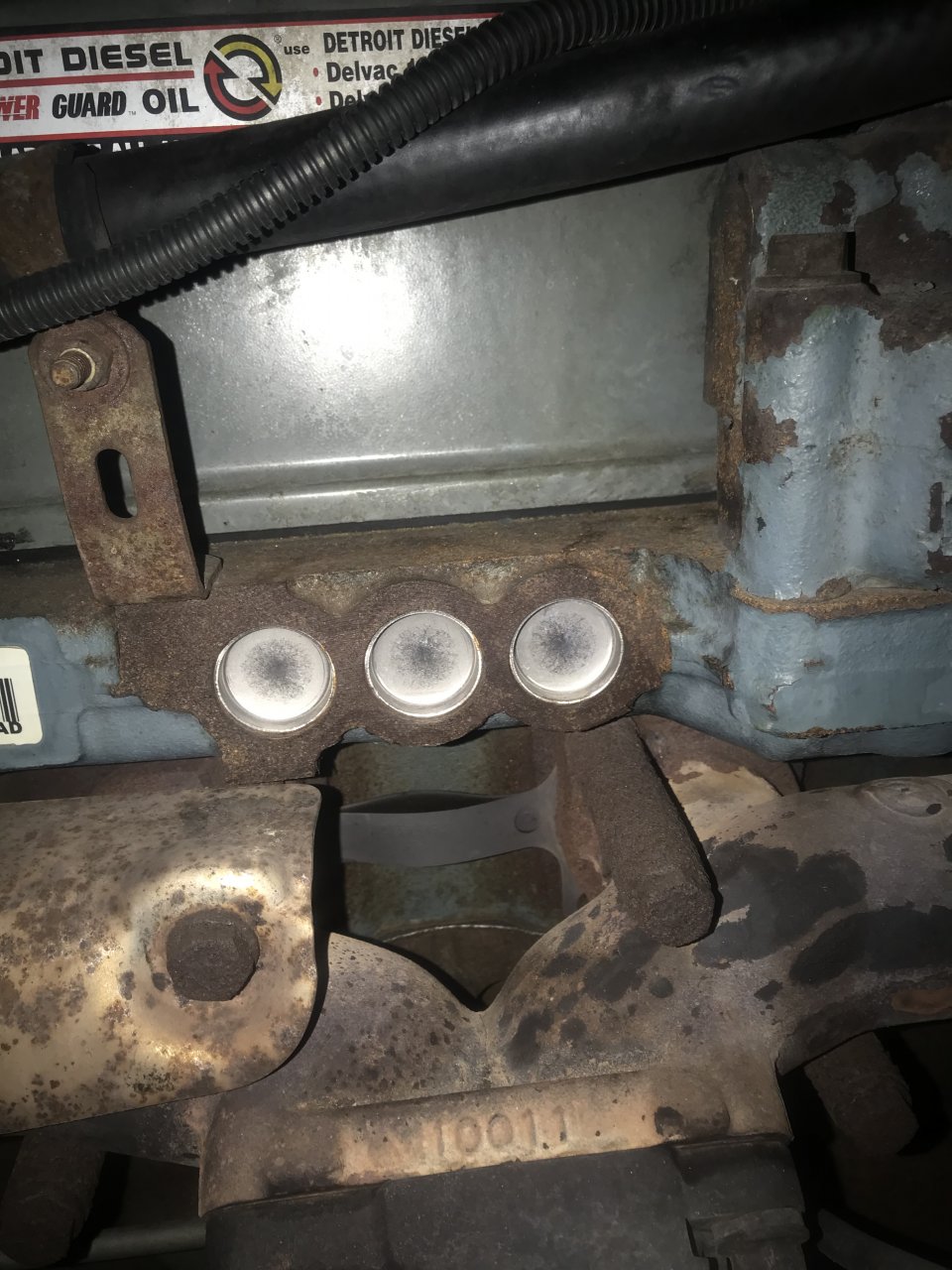

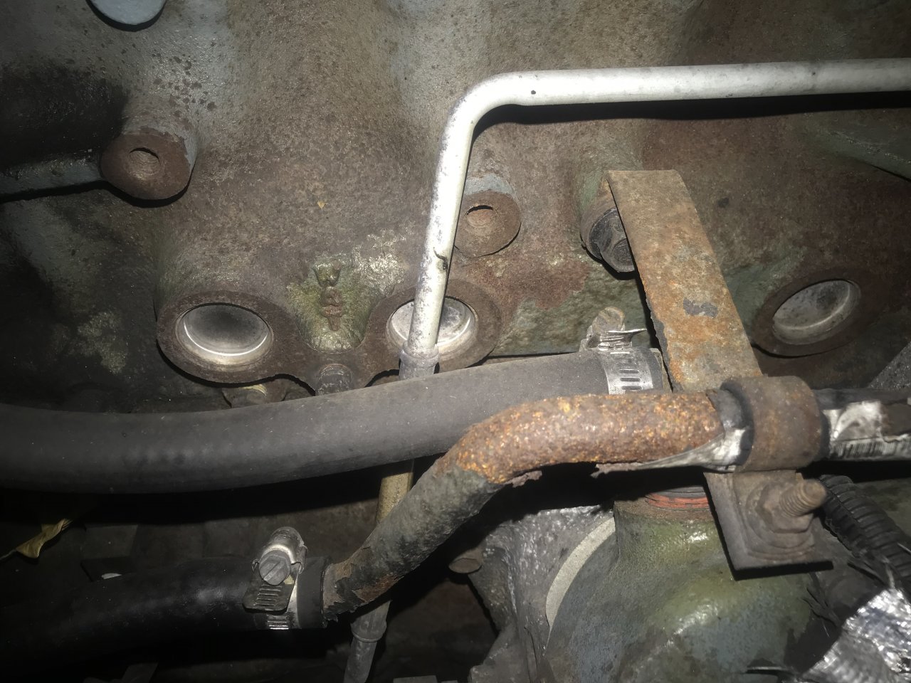

Hey guys just a quick update I got a couple of pics of what I believe is the freeze plugs (7 of them) and none have popped out. Is this a good sign or may it mean the water expanded to other parts of the block?
Rideandrepair Thanks this. -
I really do think your fine. Anything leaking? Anything on the ground? If not then your good to go.
Rideandrepair and isaitrujillo8 Thank this. -
lwlevens said: ↑I really do think your fine. Anything leaking? Anything on the ground? If not then your good to go.Click to expand...Rideandrepair Thanks this.
It will sometimes push a freeze plug out, but can crack without it too.
We have always called them freeze plugs, but that is not what they are there for. lolRideandrepair and isaitrujillo8 Thank this. -
starmac said: ↑It will sometimes push a freeze plug out, but can crack without it too.
We have always called them freeze plugs, but that is not what they are there for. lolClick to expand...starmac and Rideandrepair Thank this. -
The freeze plugs are meant to avoid a cracked block. For that reason, I’d rather see them popped out. Hopefully it’s fine, I’m a little low on A/F myself right now. Had a clamp break, added water. Cold weather caught us all off guard, this year. Soon as I get home, new hoses and A/F. Lol
isaitrujillo8 Thanks this.
