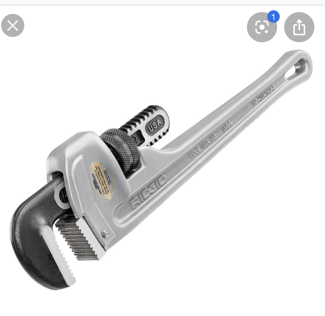

    Pipe wrench is all you need.

    Do you have a pic?

    I mean to break the tie rod loose from the steering knuckle.

    Just take the nut off and bang with a hammer or mini sledge. Your gonna replace them anyways.

    Never had any luck with those. Besides it destroys the grease boot so if you had to change a bent cross tube that had good ends, you'd wreck them.
    Usually a couple good, solid blows to the back of the ackerman arms will drop the tie rods. Usually there's a flat spot or pad there to hit.

    I have hit the steering knuckle with a heavy Sledge but it didn't break loose.
    If that's okay I'll put the old nut on it and I'll I'll hit it with a sledgehammer. For some reason I thought you're not supposed to drop it that way.
    New ends are going in.
