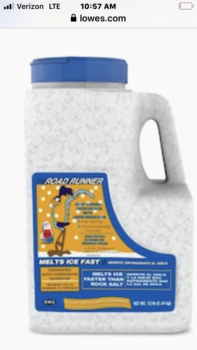

    F2C6C4FA-9A54-45C9-94C8-61BA3F4561B6.png This stuff is good to have. Less than $10, the jug is handy, instead of a bag. Any brand, Calcium chloride, Especially good for dropping or hooking a trailer on ice. Only had to use it a couple times. Some on the ground, and some on top of the drives in the tread. Works great. I also carry a propane torch. Good for melting ice blocks inside brake drums, after being parked, and brakes won’t release. Again, only had to use it a couple times, in over 20 yrs.
