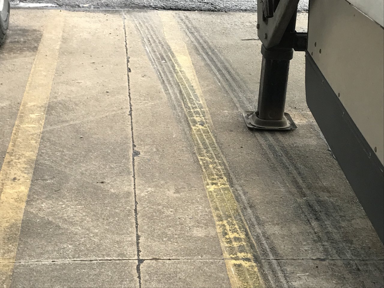

    Definitely dragged. On the left side, what’s left of the tires were oriented differently once he noticed what happened and brought the trailer back.
    Lonesome, 201, Albertaflatbed and 4 others Thank this.
  4. TripleSix
    18,830
    131,917
    Bet money that the inside tire is showing the cords. When the outside blew, it’s off the bead and rotated at a different position than inside.
