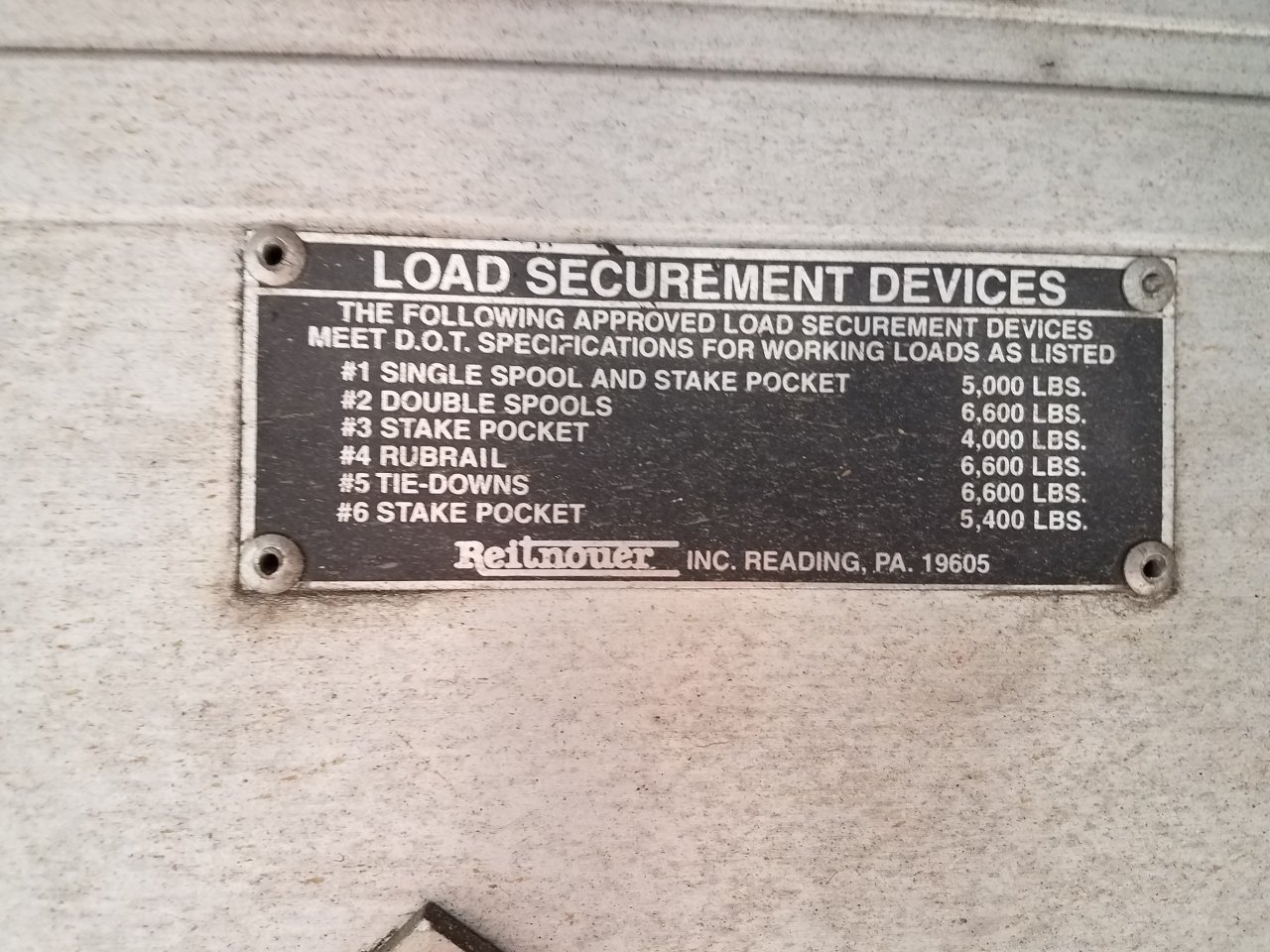

    Seems I was mistaken. My rub rail is rated for a bit more than I thought 20161105_093127.jpg

    I assume you only ever attach to the 5400 lb stake pocket and never the 4000 lb stake pocket. :D

    Thing is, I'm not sure how to tell the difference seeing as neither one is actually marked on the pockets

    Yeah, that was kind of the point. I've seen plaques like that before and just shake my head.

    It has nothing to do with the pockets, the different rating is for how you hook the chain.
    A 4k rating for a pocket on an aluminum is typically when you use the hook to grab the pocket. 5400 would be if you wrapped the chain all the way around the pocket and hooked back to the chain.
    If the trailer doesn't have a plaque with a diagram showing what the ratings are for, the owners manual should.

    Have any supporting theories to back that?

    Scroll down to page 32 on this Fontaine Manual.

    Some good information there, thanks. I was recently reading somewhere that hooking to the stake pocket wasn't as safe as wrapping the chain entirely around it due to the pressure point being mostly on the hook itself. It seems, according to Fontaine, that isn't true since they give either scenario a WLL rating of 5,400 pounds.
