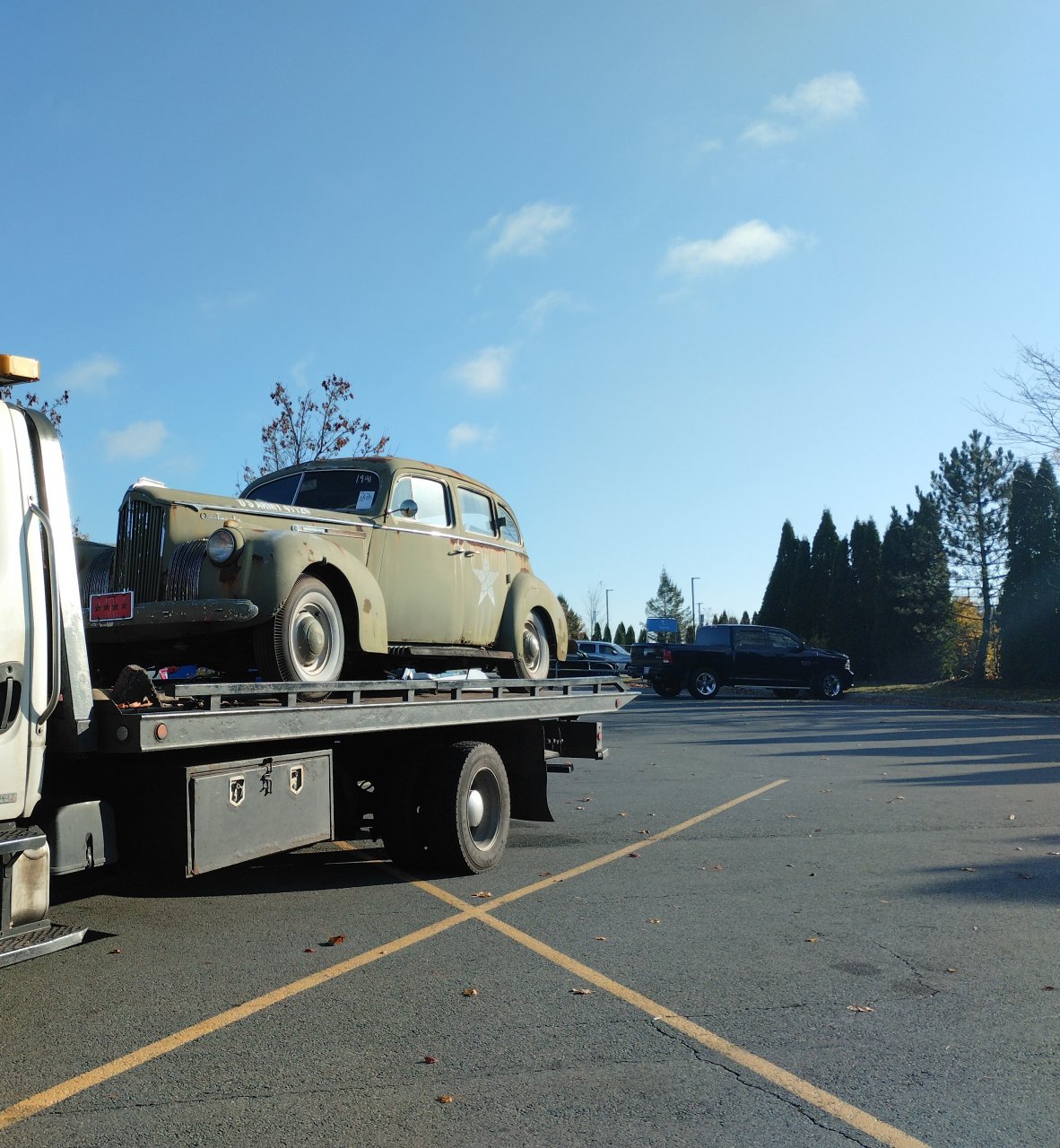

    Going to auction to pick up 1941 Packard, 2 plus hours away in wilmington, Delaware.
    Get there and load, about to jump on 95 North ramp, top rad. hose blows. I stop
    with people pointing, and taking pictures of the old car.

    So how about a picture of that Packard?
