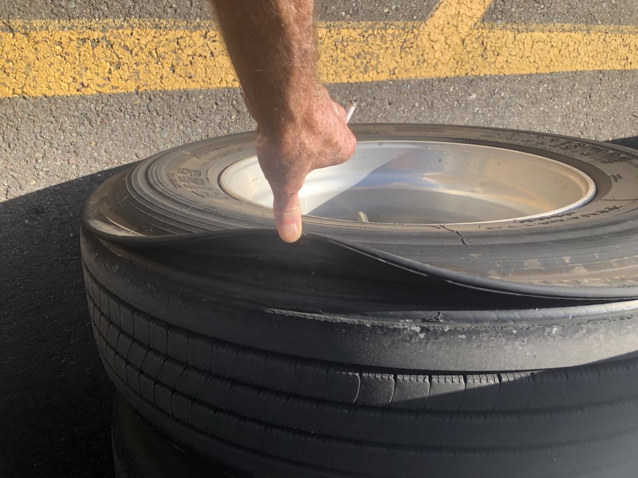

Would you drive on this tire? (picture)

    You'd drive on that tire?

  4. ncmickey
    ncmickey Road Train Member
    3,830
    7,145
    Jun 21, 2013
    Durham NC
    She stood her ground and told safety. Tire was changed.

  6. MartinFromBC
    2,769
    12,477
    Oct 19, 2018
    Hauling gravel, logs, equipment, tires get cuts OFTEN.
    Just drive on it till I get around to changing it.
    Put 14 new tires on a truck this past weekend, the best tire on it looked worse than that.
    If we stopped ever time it got a tire cut, we would get nothing done.
    A lot depends on the type of work a driver does.
    Rideandrepair and lilillill Thank this.

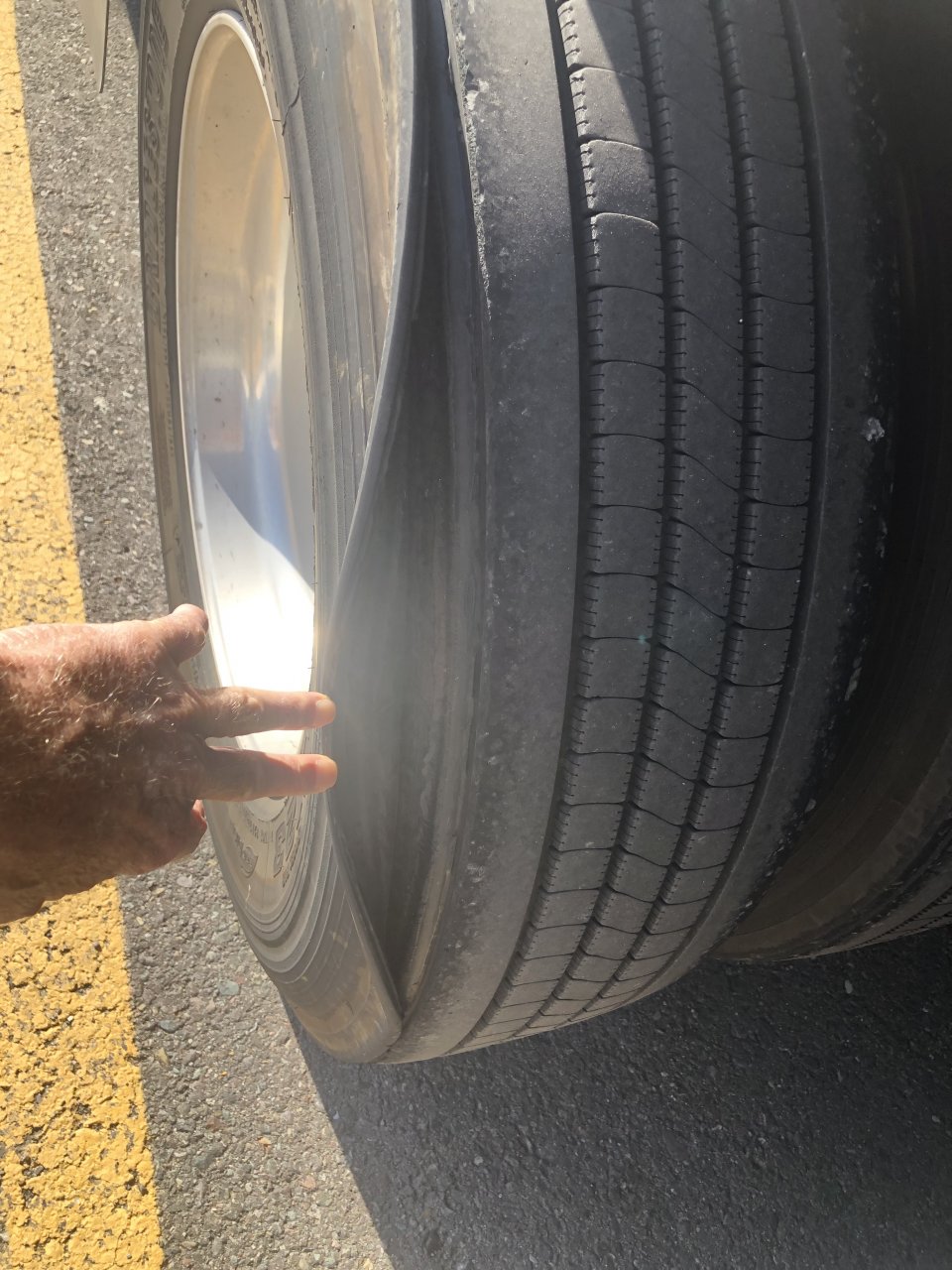

  7. Concorde
    Concorde Road Train Member
    4,715
    16,852
    Jun 29, 2016
    West Melbourne Florida
    E600241B-349C-4941-9918-24E39789C164.jpeg 195F59AF-CBD3-46E2-88A5-620D244AEEE2.jpeg
    Branding layer of rubber?
    Like this?
    I rode on this one for a week and only replaced it because dot probably wouldn’t like it. No cords showing.
    TA replaced the 295 lo pro with an 11R..accidentally.
    Next day another TA gave me two new ones installed for free :)
  8. aussiejosh
    aussiejosh Road Train Member
    4,709
    5,409
    Aug 28, 2009
    Airlie Beach QLd
    Steer tyre no way, not at high speeds if you were running empty at speeds under 35 mph it'd be a little safer but still risky. What I'm wondering is how on earth did that happen to your tyre in the first place? Trailer tyre maybe over a shorter distance would not try to run it all day specially in super hot conditions its likely to let go at any time. May sure you stand clear of that tyre to.

  9. Diesel Dave
    8,723
    24,991
    Jan 20, 2010
    Hesperia, Ca.
    That’s a recap, If you haul light, I would flip it and run it on the trailer where it’s not noticeable. But I would only do it IF money was tight.
  10. SmallPackage
    5,460
    17,359
    Dec 20, 2019
    Marion Texas
    Branding layer of rubber is the extra thickness added to sidewall for branding id codes, names, or numbers. Most manufactures add a placard spot that says “brand here” on it. Don’t want to burn more than 2/32’s deep in most cases.
    What you have there looks like it may be what they call a “lifted tread skirt” were the tread cap comes loose at its skirt were it is fastened to the shoulder of the casing. and causes outer layer of sidewall rubber to separate. New virgin tires are put together like retreads. The tread cap is added to the body of the tire before it is molded together. Tread Separations on brand new out of the mold tires happen from time to to time.
  11. SmallPackage
    5,460
    17,359
    Dec 20, 2019
    Marion Texas
    The tire in the ops pic is not retread. If you look you can see “Bib” the Michelin man at the shoulder pointing out the treadwear indicators. Michelin retreads don’t have this. It just says “twi”
    The mold flashing you see is what we call foreskins. New tires have this too and are usually cut,shaved, or ground off a little better.
