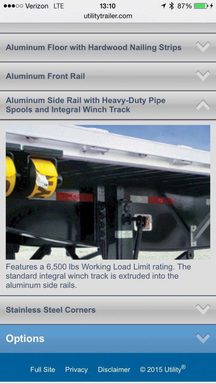

  8. spyder7723
    spyder7723 Road Train Member
    15,471
    25,076
    Mar 31, 2013
    sarasota, fl
    The description of your attachment flat out states you have a winch track. Just a different type that a typical platform trailer has.

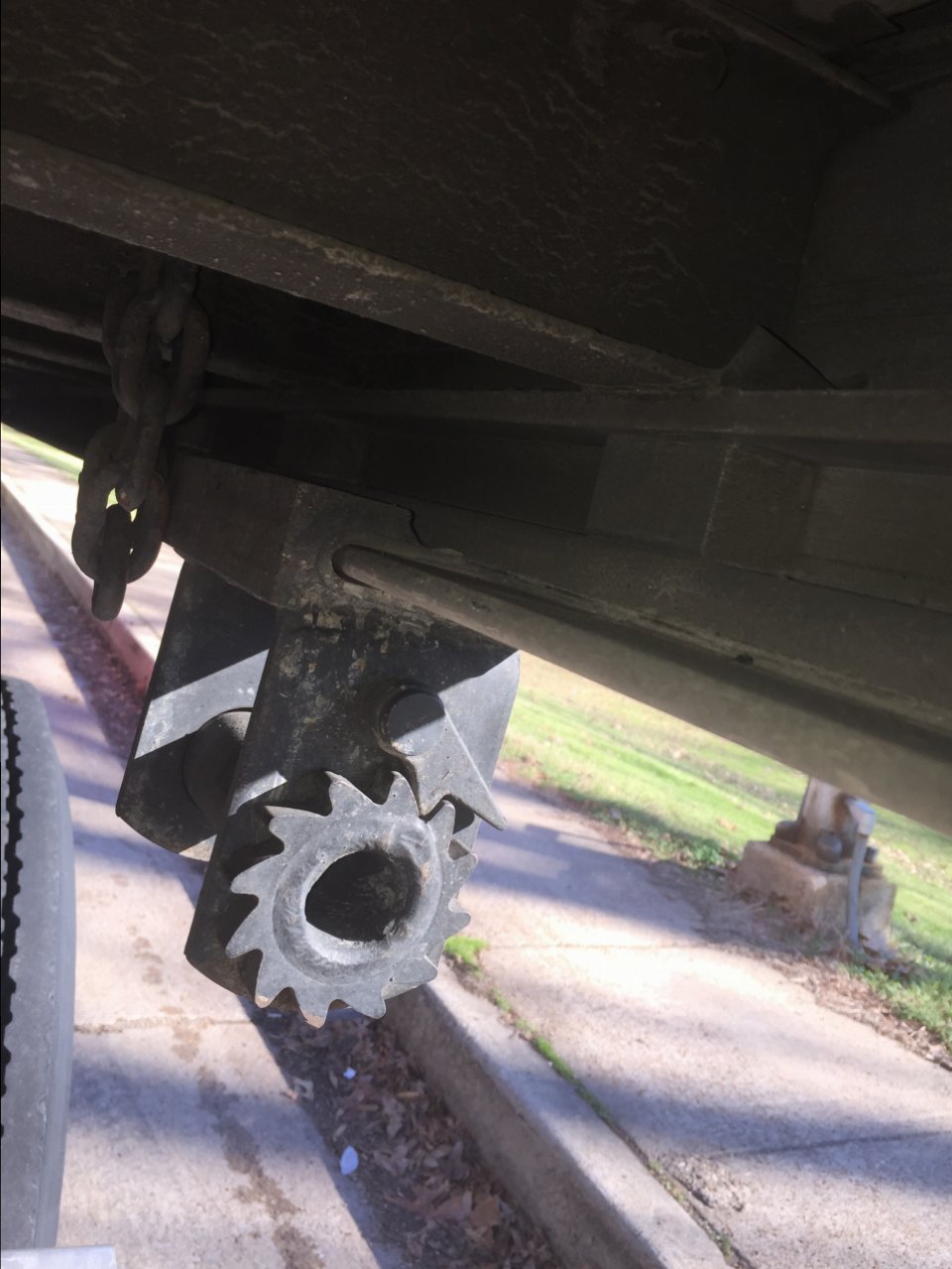

  9. kylefitzy
    kylefitzy Road Train Member
    4,725
    19,670
    Aug 12, 2007
    Kansas city,Mo
    Here's a picture on the actual trail I'm referring to. Take what you will from it.

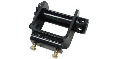

  10. johndeere4020
    8,522
    119,294
    Jan 1, 2010
    This is what @spyder7723 is talking about I think, if you clamp them to the rail it will bend it pretty easily. The side rail isn't designed to take the extra leverage that this type of winch exerts.
    spyder7723 Thanks this.
  11. kylefitzy
    4,725
    19,670
    Aug 12, 2007
    Kansas city,Mo
    That's the exact type I'm talking about. They actually would apply less leverage then the stock winches. They are much shorter. The only difference in how they apply force to the trailer is the bolts.
