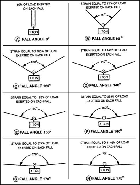

    X chains on shotgun coils bug me for some reason. I don't think it's really that strong.
    This is for lifting but we are basically doing the same thing just the other way, kinda upside down. Figure A looks closer to what you'd get with the horshoe method, from the eye to the deck at 90° that is. An X chain might be closer to figure E.
    The flatter the chain, less of an angle, the weaker it's going to be.
    The rules may say it's OK but I don't buy it.
    Bean Jr. and Lepton1 Thank this.

    Well how else would you secure a shotgun coil? Because a horseshoe chain is only good for 1/2 it's wll since you hook from one side, around the article, and then hook it back onto the same side of the trailer.

    Horseshoe , trip chain and, secure over the top is what I do. There is more friction there than from X chains. Not saying it's the "right" way, it just feels better to me.

    So the only difference in mine and yours is i have more securement because i do all what you just stated, plus use the x chains.

    I'm just wondering what's so special about X chains. They don't seem to do much good.
