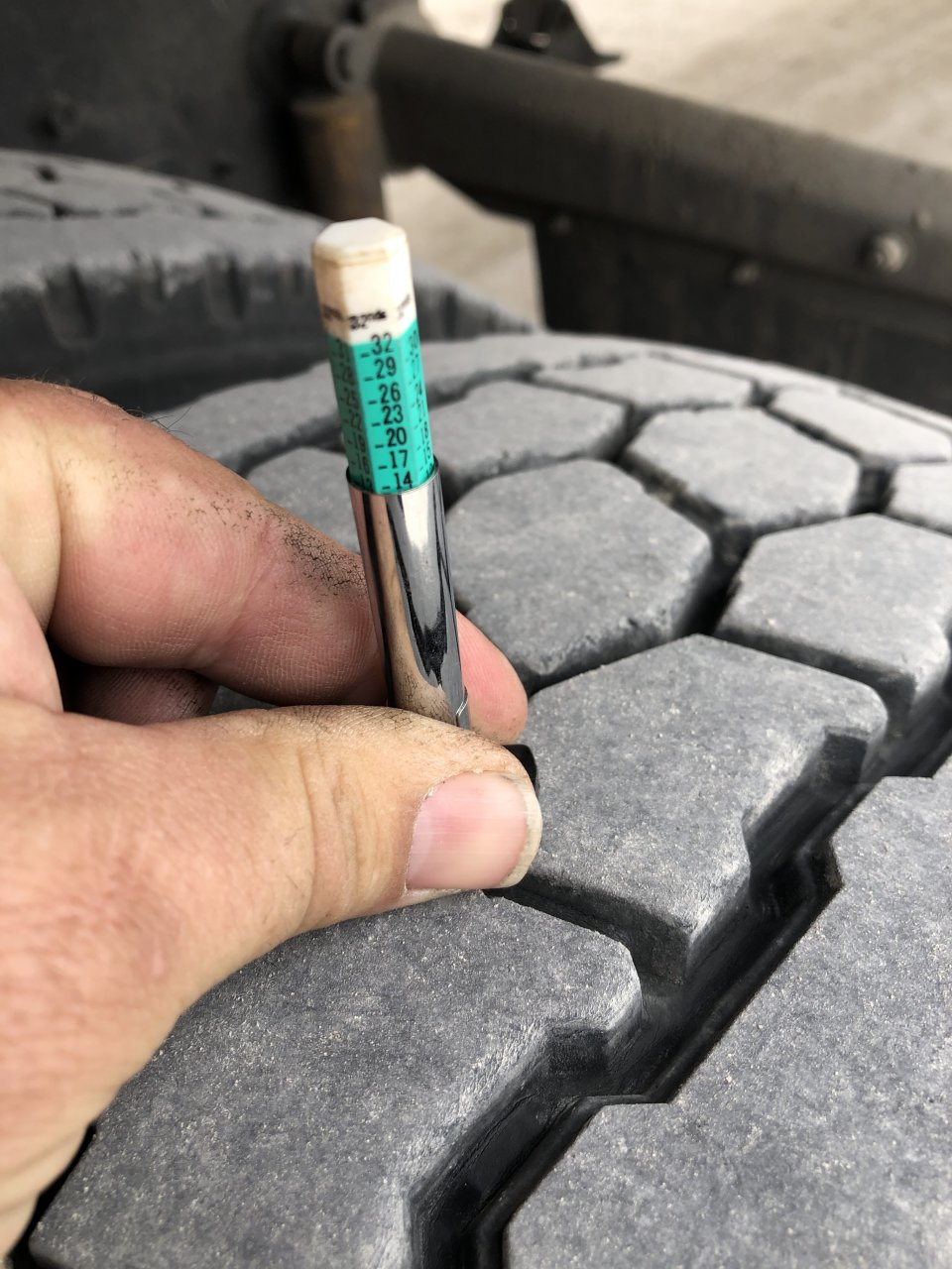

    Careful making blanket statements about tire pressures. I run 90 in steers and trailer and 80 in drives..
    Perfect flat tread all the way across. I used to run high pressure like you but found it only caused a rough ride.
    No increase in fuel economy
    No increase in tire life.
    These have about 160k miles on them at 80lbs F0CB1CB6-5158-4147-A483-1577E8F4B3F0.jpeg

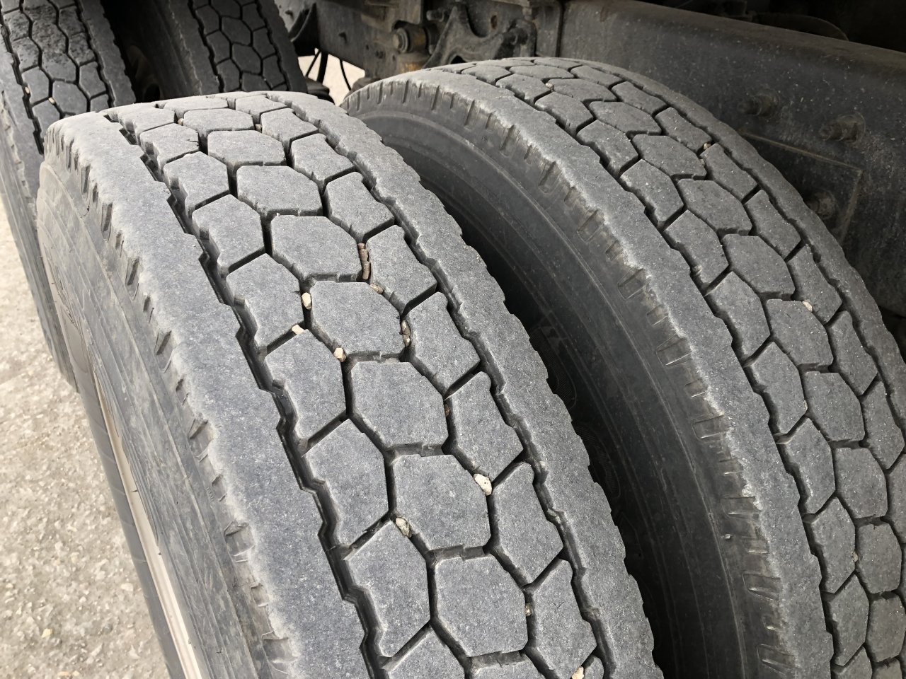

    Its amazing what people believe. Yoko 703zl about 100k on mostly 2 lane. 90psi. They like to hold stones however.
    JoeyJunk, Tug Toy and bzinger Thank this.

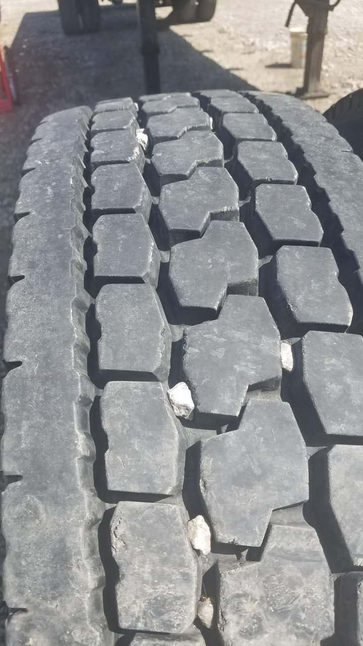

    My bridgestones also love to pick up gravel and if you leave it in there it will wear a hole eventually.

    When Im waiting I just walk around and pick stones. My lot is stone, and Im in and out of a lot of elevators. Rock drilling its called and can ruin a tire or casing.

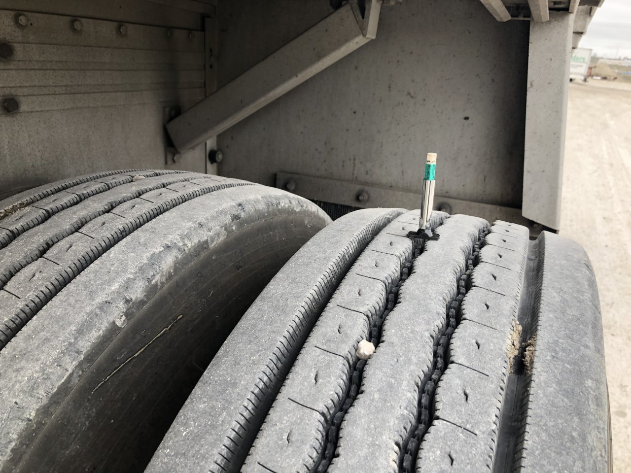

    Drives. 14/32 every tire all across Dayton D610 732B2E4E-253D-46E1-8BF2-5FC8B7B0977B.jpeg spread trailer with about with about 90k miles 18/32 firestone 561 69B6CCC3-F830-4F66-94F9-D8694AB5223E.jpeg steer with about 120k 16/32 continental 4 FC3487BE-5231-4CA3-B79E-96C8827791B2.jpeg
    All have even tread depth across all grooves.
