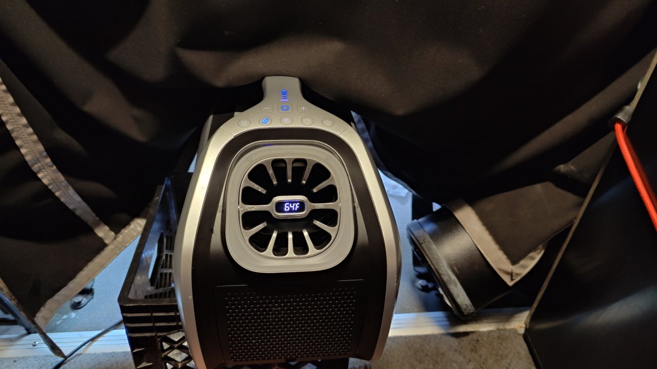

    IMG20220614065746.jpg IMG20220614083450.jpg IMG20220614091216.jpg Night went well. I woke up at 6.30am, because I got a bit chilly, but thermometer showed almost 80 degrees, I can only assume it's because it was on the shelf, while Zerobreeze was pointed at my bunk.
    The other pics show temp in front of the cab and at the top bunk.

    Overall I am happy with the result, since it is what I expected. I did not wake up once till the morning and usually I already run AC at night if the temp is above 72 degrees.
    It's only gonna work if cab is precooled before going to sleep and it's only gonna be fine till about 8am, after that it will become warmer and warmer in the truck.
    For the best performance, like I originally thought, curtains dropped from the top bunk to isolate the bottom, will create very small sleeping space and Zerobreeze can completely freeze you in there.
    People with mid roof or even smaller cabs than my Volvo 770 might be just fine with the closed curtains.
