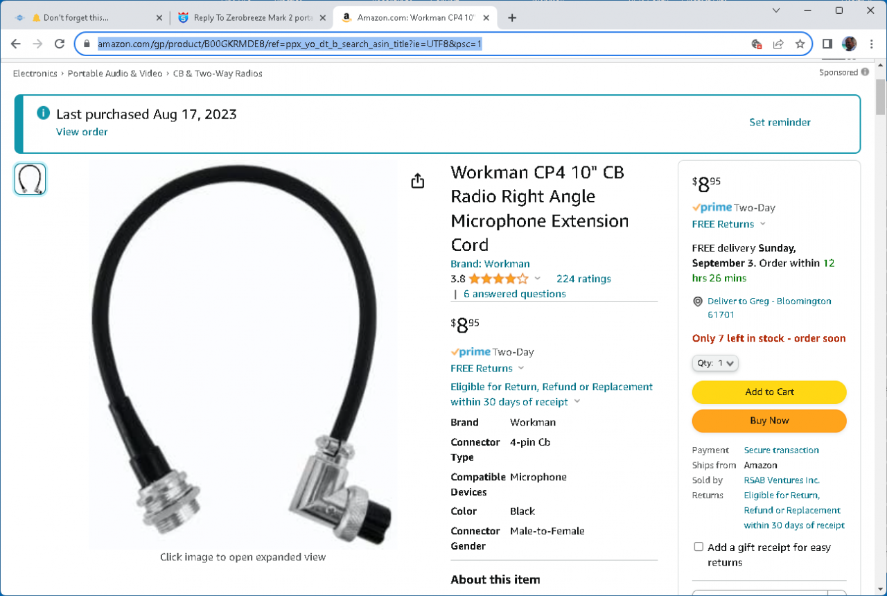

    Hey, good morning. Not sure where to post this, but I have what I think is a great ZeroBreeze tip for truckers. I have been frustrated with the recessed 4 pin connector on the ZeroBreeze batteries -- anybody who has tried it knows that you can't get your fingers in there to turn the knurled nut, leaving the connection loose. Not good and a good place for a battery surge.
    Just guessing, I tried a Workman CP4 10" CB Radio Right Angle Microphone Extension cord. This fits perfectly (male to female extension for the recessed port) and allows the port to easily accessed to connect the unit or combo battery device. Use needle nose pliers and tighten the knurled ring nut ONCE!
    You can find this on Amazon for $8.95 - I bought one for each of my 2 batteries.
    https://www.amazon.com/gp/product/B00GKRMDE8/ref=ppx_yo_dt_b_search_asin_title?ie=UTF8&psc=1
    Please spread the word as I'm a newbie and can't start a new conversation yet. Thanks!
