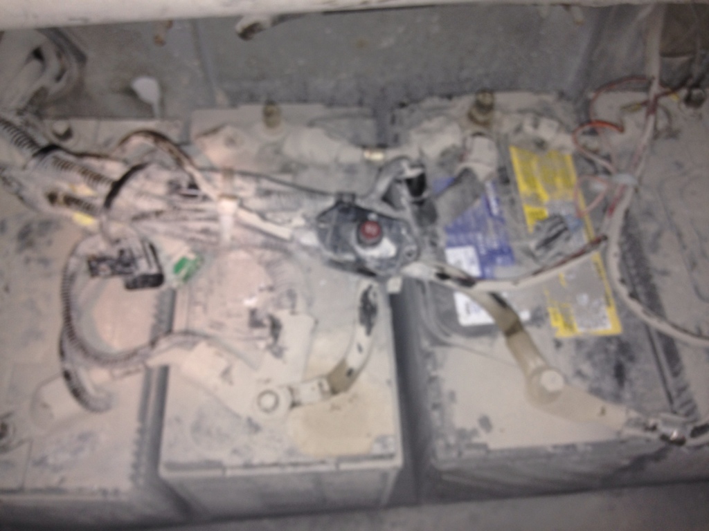

    Had the PTO going and all of a sudden it died. Could get the transmission back into drive or reverse. I have a "SM" on the readout.
    Turned everything off and back on. Disconnected battery for 15 minutes.
    Checked all the fuses with a test light on the drivers foot panel.
    Weird thing is the light that illuminated the F N R is no longer on. It's like its dead.
    Any ideas. Kinda stranded in the middle of nowhere.

    In side batt. box you will find a fuse inside single fuse box CK. inside to see if it is blown?

    Checking now.

    No luck. One 30 amp fuse and one 120 switch.
    I pulled the 30 amp and the truck shut off.

    I found the fuse. It's good, I pulled it and the back up alarm started going off. Put it back in and the Meritor display cycled through.

    When its light out pull the fuse conn. at batt. an clean them

    Thanks for the help. I found the culprit. This line was disconnected.
