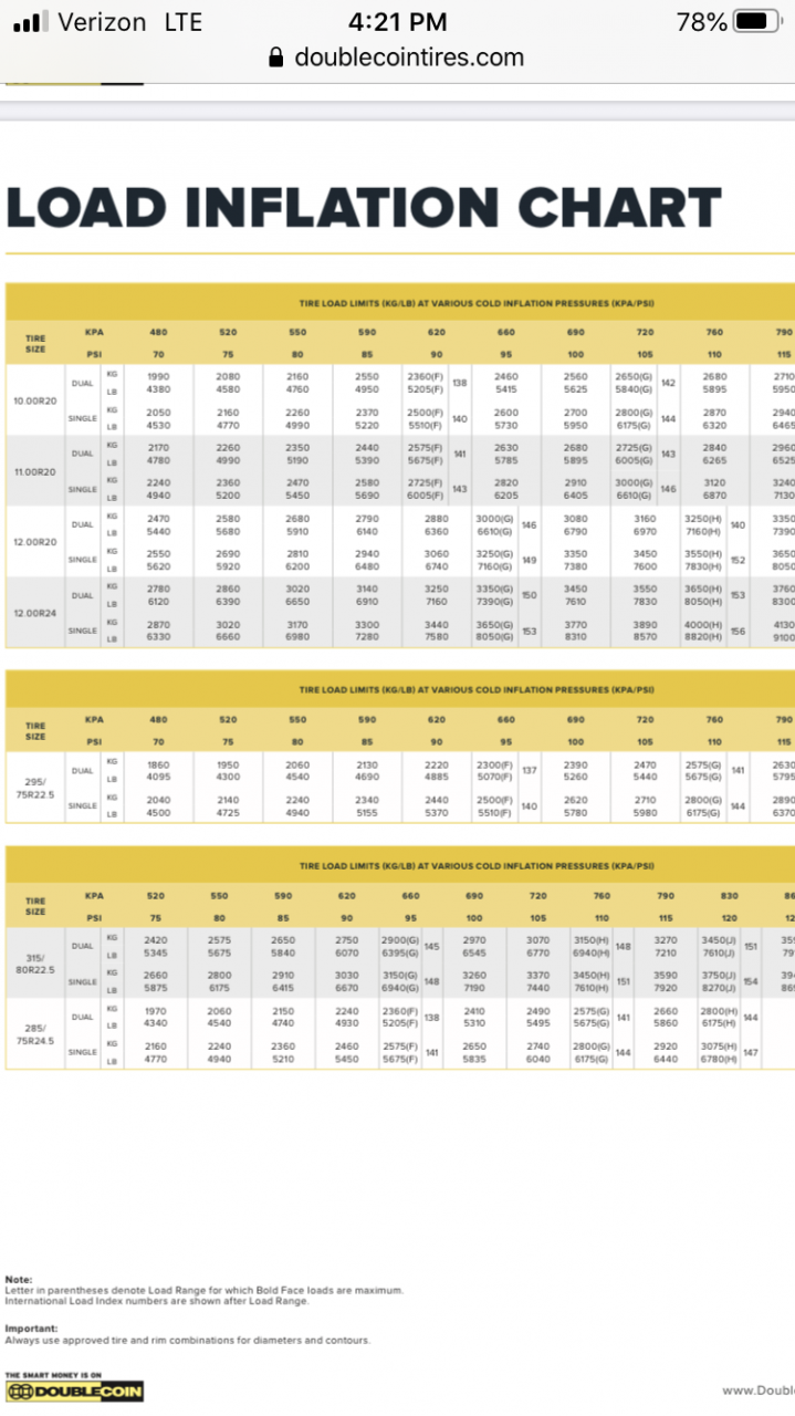

    14 and 16 both have 4 steel plies in tread and 1 steel ply in sidewall. The only difference is the inflation pressure to make the difference in load rating. Cut one open and in sections and it is the same construction.
    The same with passenger tires like an Extra Load rated tire like a 235/75R15 XL is just a higher inflation. Usually 41psi from 35psi standard load.

    He is correct on pressures. Mast, BFS, and GDY all agree on the same industry standard pressure recommendations. That is own reason why you will never find a Penske truck or big fleets with more than 95 psi in a tire.

    FET is based on tire weight, IIRC.
    Higher pressures yield lower temps at any given load. The manufacturers test at various pressures to see how much load it takes to overheat the tire. That's the numbers in your load charts.

  8. Judge
    13,300
    87,781
    Chart, Chart, Whose Got the Chart?

    It’s hard to explain but heat generated pressure is much higher in a tire that is overheated by overloading and flex stressing of the sidewall and bead bundle then ambient, direct sunlight, or road surface heat can produce. We’ve gone through numerous testing seminar's both live at proving grounds and classroom video conference that show what heat will do with psi.
    A tire maxed on weight but running 100 vs 105 could be running 60 degrees hotter in same climate and road conditions due to flex. This is why in the early 2000’s they raised max psi from 100 to 105 when the truck speed limits were raised.
    They did same with Passenger tires and raised psi’s on many of them from 35 to 44 when states rolled out the 70 speed limits.

    Something else to keep in mind also is most wheels are only rated at 120 psi max and around 7200 lbs load. So a LRH “16 ply” is pushing the capacity of the wheel it is mounted on.
    Like @Hammer166 stated the new LRJ’s “18 ply” are going to need wheel manufactures to update ratings before they can become mainstream. Not going to happen anytime soon because the industry as a whole is looking toward the EV change and that means different wheels and tires entirely.
