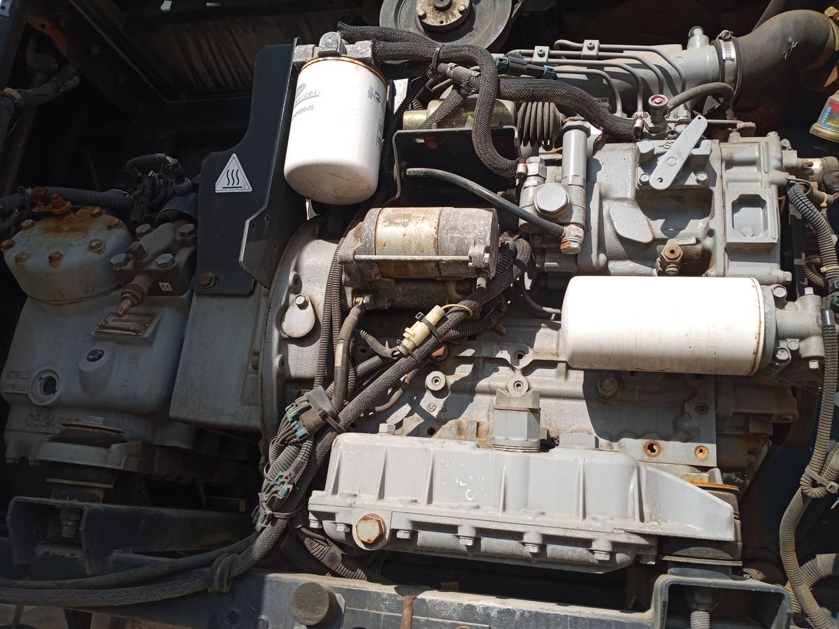

    I'm
    looking to purchase this reefer with this unit and looking to see if this is a good reefer in general?
    Parts availability, Part prices, fuel consumption, noise and labor costs on repairs.
    I plan to use this trailer for Nursery loads. Thanks!
    its been sitting for about 5 years.

  7. MandoDub
    MandoDub Bobtail Member
    33
    116
    Jan 19, 2017
    USA
  8. reeferwrencher
    reeferwrencher Medium Load Member
    552
    1,469
    Aug 4, 2018
    If it starts make sure its charging,set it for -10f,make sure it goes onto high speed.Check if the ball is floating in the sight glass on the receiver tank,which is a long cylinder located on the curbside of the unit.Also check delta t reading which should be at least-15 after running for a while.
