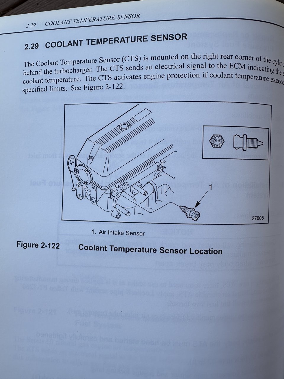

Passenger side of head I think there’s 3 sensors.
@sawmill explained it better to me, but I think one is high temperature, one is lower temperature, one to guage?
Thinking that the high temperature sensor may be bad?

So there is 3 on that side of the head. Far right is the ECM with power and ground the other 2 is what I'm not sure which one is which.....I also put a volt meter on those and there only getting around 4 volts. Should they all be getting 12?

I’m not sure what voltage or resistance they should measure at.
@sawmill , @pushbroom @OLDSKOOLERnWV ,
I’ve got to run to the store, but I’ll grab the shop manual when I get back if someone smarter than me hasn’t chimed in. -

Yes so that is the sensor that I have already changed. The other sensors are single post. I know one goes to the gauge but I don't know what the other single post sensor does.
