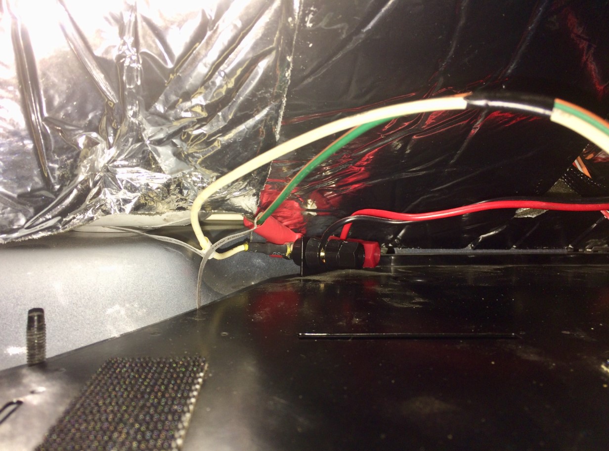

    Anyone know where the power wires are for the CB for this truck? Our mechanic pulled the whole top of the overhead compartment down looking for it and nothing. We found the antenna and CB speaker wire, but that's it.

    Take the plastic cover off , they are behind that box.

    We did. They are not there. The mechanic looked for 20 minutes.
    I just pulled the panel AGAIN and looked. That website provided a photo saying where the power terminals were. This truck does not have those.

    Correct they do not! My ‘23 Pete has a CB power wire with that stupid T shaped connector on it. The connector goes to nothing that exists in this world as I’ve asked for years and nobody knows.
    So you simply cut it off and wire your CB directly…until now. My wire had no power to it and the fuses are good. So I ended up buying a 12v cig lighter cb cord. I’ve still gotta route the wire under the glove box and up the A pillar but at least I have power now.

    IF it has power to it when the key is on, it is for the CB, it is a simple OEM connector which you can buy cheaply off of amazon, Aliexpress or eBay.
