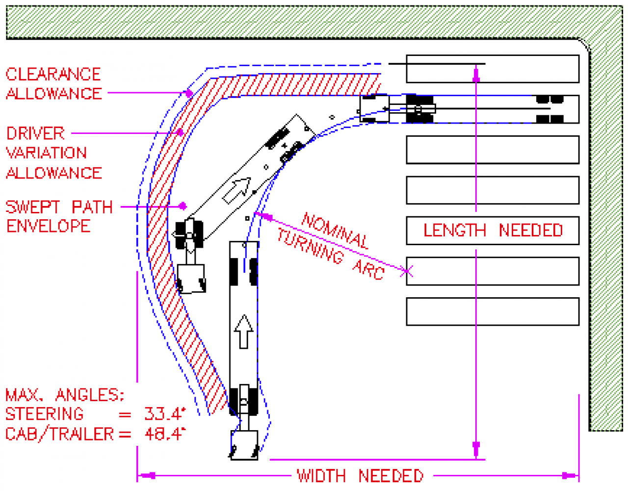

    Most building codes set the minimum size of aprons at loading docks assuming a 90 degree dock by a typical truck. Using a 45 degree dock will take more space because it increases what they call the "Nominal turning arc" in this graphic.
    It always seems like if they do give you more room people end up putting stuff there anyway...but I just use as little angle as required.
    If you start thinking in context of your trailers tires when backing up and then build an intuition of your tractors swing vs trying to follow formulas it will become a lot easier.
    As others have mentioned, managing space on your passenger side is all that really matters when you are on a private apron.
