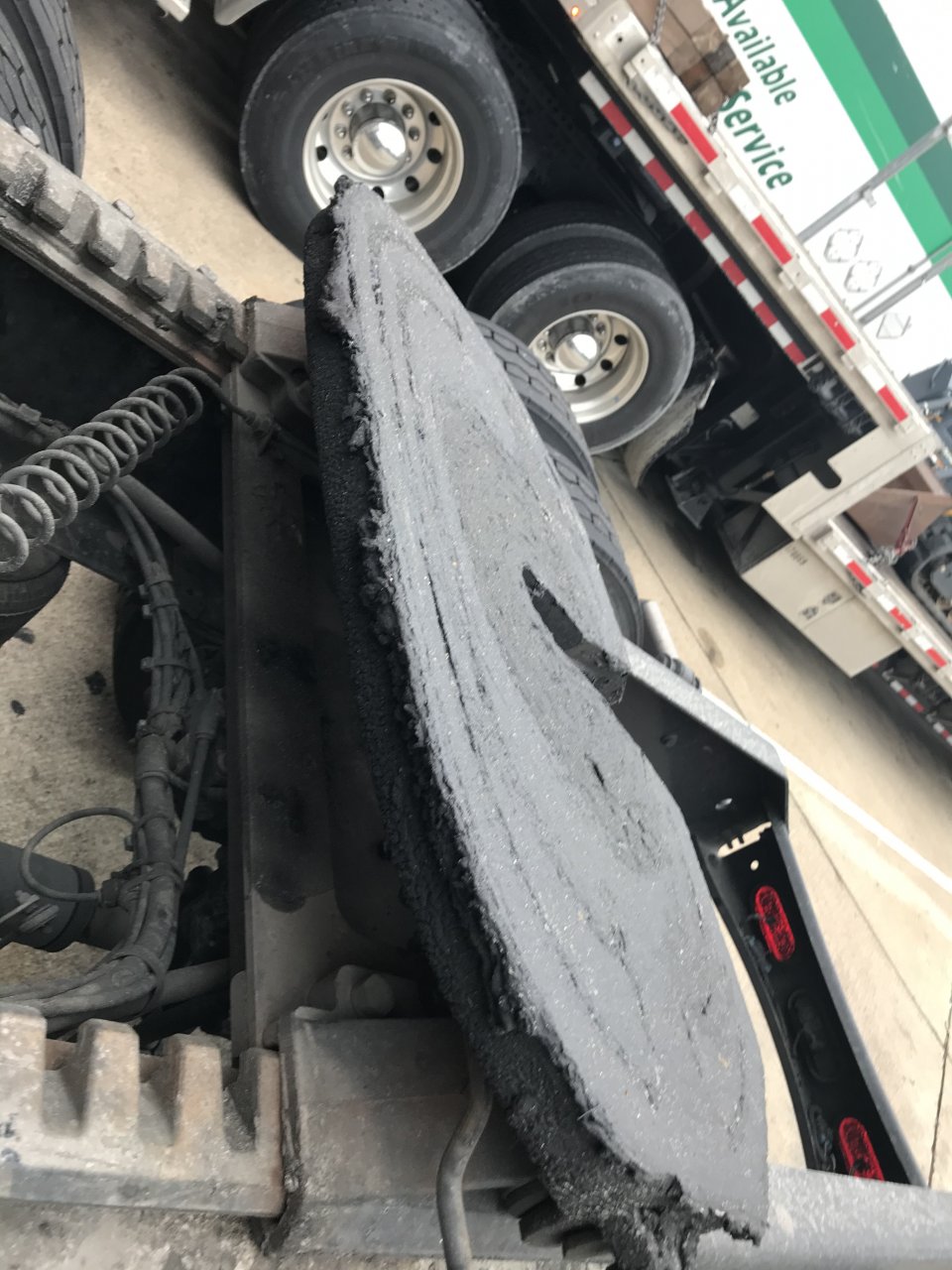

    Theres gap in that picture. Mine was pushing out grease from the sides, couldn’t keep it on there. As I understand, they wear on the sides, if poorly maintained.
    I had a front to back slip - thought it was driveline until I’d eliminated all other possibilities.
    Do you have trouble keeping grease on it?

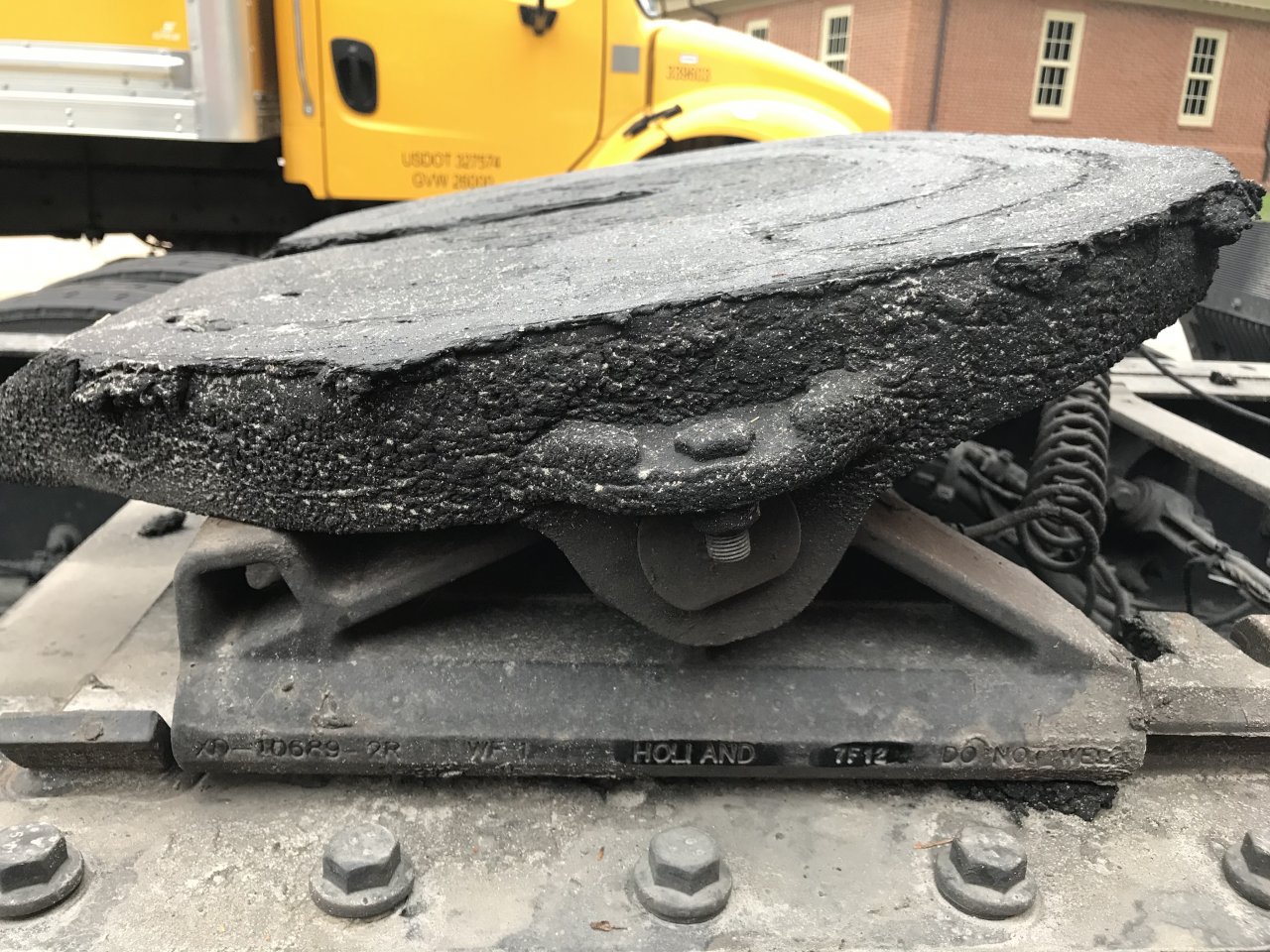

    That's the OP's fith wheel.(i think......lol)
  8. daf105paccar
    6,564
    7,293
    Apr 15, 2012
    @Midnightrider909
    look at the video at the 48 second mark.
    If it is a Holland FW 17 as i suspect you can see where they put the tag with the serial number.

    No. It’s way too greasy as it is. I use a little lucas 5th wheel lube whenever a hook a new trailer.

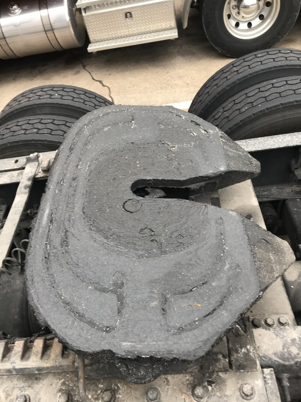

    I think I might have some front to back slip too. Here’s some pics:

    I don’t have a lift. I did see a stretched spring attached to the jaw. That might be the problem.
