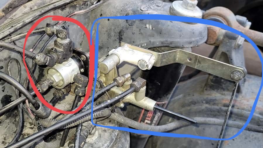

    What kind of truck is it?
    My 379 has a leveling valve and a pilot valve. I replaced both, the leveling valve was pretty trashed and I replaced it, The pilot valve was the real problem in the air bags not inflating. When you dump your air bags this is part of that system. One days it worked great, next day no air.
    Leveling valve cost about $70-80
    Pilot valve is $30-$40
    Easy replacement yourself, just make sure new leveling valve is adjusted the same as old one.
    Peterbilt wanted almost $400 for leveling valve... truck pro $79... really hard to find stuff not made In China now. Peterbilt parts
    had no idea what the pilot valve was...
    Pilot valve in red, Leveling valve blue circle. Your truck may not have a pilot valve.
