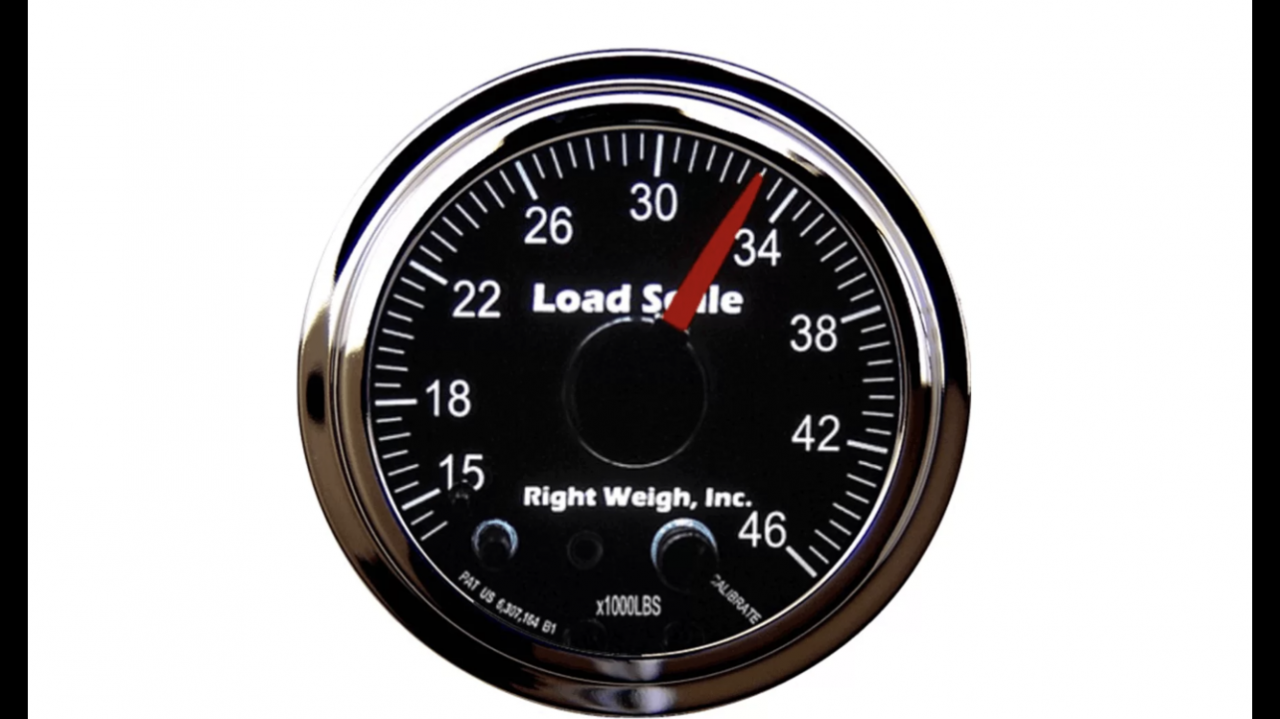

    @Judge
    Dont you have one of these fancy air scale systems?
  7. Judge
    13,247
    87,276
    i have right weigh on freightliner but it’s not with the 8 bag suspension, for that i’ve just got an air suspension gauge
    Works better for me, because on the digital one it goes up slower than the product they put in trailer at bulk.
    OLDSKOOLERnWV and Oxbow Thank this.

  9. Judge
    13,247
    87,276
    Mine is still 34, but, a hopper some of rear hopper does add weight to drives/steer
    So I have to pull forward to load rear at 30, and when it’s loaded at 80k it’s shows 34, the trailer has a different gauge, it ands 72.5 lbs showing and that gauge goes to 95
