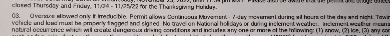

    Unless something changed very recently, nm does not have a state wide curfew. Up to 10’ wide has continuous movement. That’s what my permits from a few weeks ago says.
    can you post a screen shot of you permit with the restrictions? “State curfew” just means the state implemented that curfew, not the city.

    This is the front page where is says continuous movement
    This is the 2nd page
    It has a specific restriction for Albuquerque then has a state curfew- and shows Albuquerque again...unless the 1st one is a local curfew for Albuquerque and the second is a state curfew for Albuquerque as well.

    Yea that’s the same curfew listed twice. I don’t know why, but I do know that there is no state wide curfew in NM. In my experience, State wide curfews are very rare, and they usually are only for very large moves.
    She was probably working with limited information and took her best guess based on what we typically haul. (Or she just copied a previous permit). Should it be right? Yes. Have I ever had it be an issue? No.
