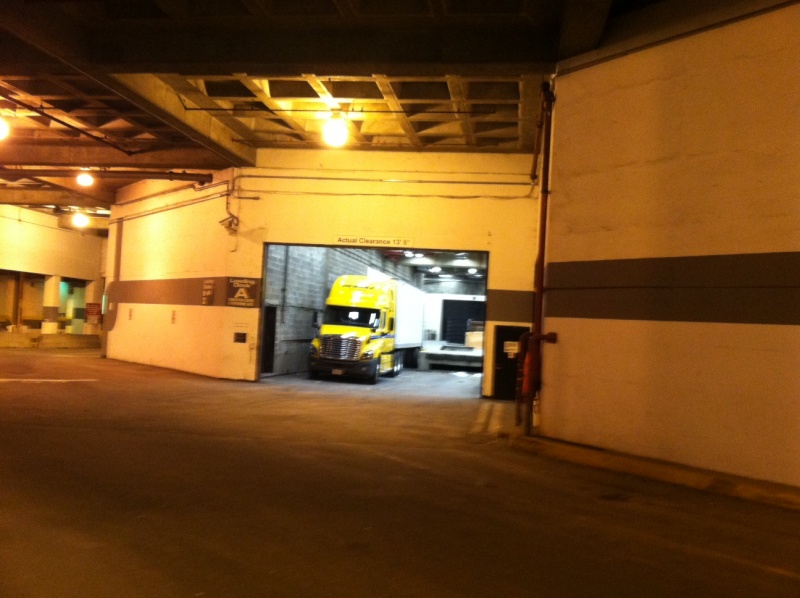

    photo-2.jpg The GOAL advice is great. But in the school I was in, you couldn't do that. Only in the CDL test did you get 2 'get out and looks'.... Doing the 90' dock for the school test it was an auto failure if you exited the truck. But that was a community college where you had the CDL requirement tests AND the tests for the school grades. They didn't want you to GOAL during practice.
    One thing along with the other great advice on this thread that helped me was when others were practicing, I watched. I didn't talk football of look at the sky, I watched others doing it. I watched their angles, their wheel positions, when they made certain moves, I watched their mistakes and how to fix them, when they moved the truck. I got so I would know how to fix their mistakes....
    But still.... it takes practice... I had to back up into a enclosed dock under 'The Egg' in Albany NY a couple weeks ago. Basically you go into a tunnel, hang a right into underground parking garage, get analized (hahaha) by the NY State police, then do I blind side back into another tunnel like dock to unload into the theatre. I had to pull up into the exit road, back accross the entrance road into the dock area,,,all with parking garage columns everywhere and trucks and cars wanted to get to the trooper shack. I had 4 troopers watching me. Took 3 pull ups but I got it! But I'm a rookie.... so you e,experienced guys would nail it I'm sure....
    School will prepare you for your test.
    In the real world...every back up is a bit different...
