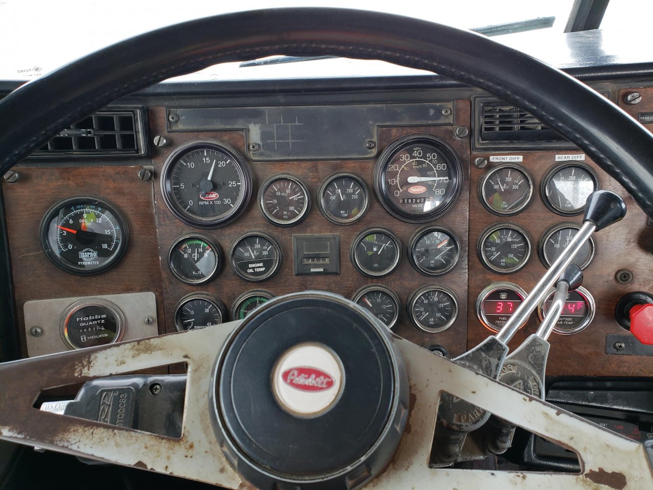

    Mine looks like the pic that Ox posted. I don’t know what you guys mean by modulation, but if I need trailer brakes only, I pull the trolley brake half way down (blew a steer at 85+ and didn’t want the wheel to get chewed up).
    I will admit that the Ox style is much easier to use than the little dinky ones that you see mounted to the dash.
