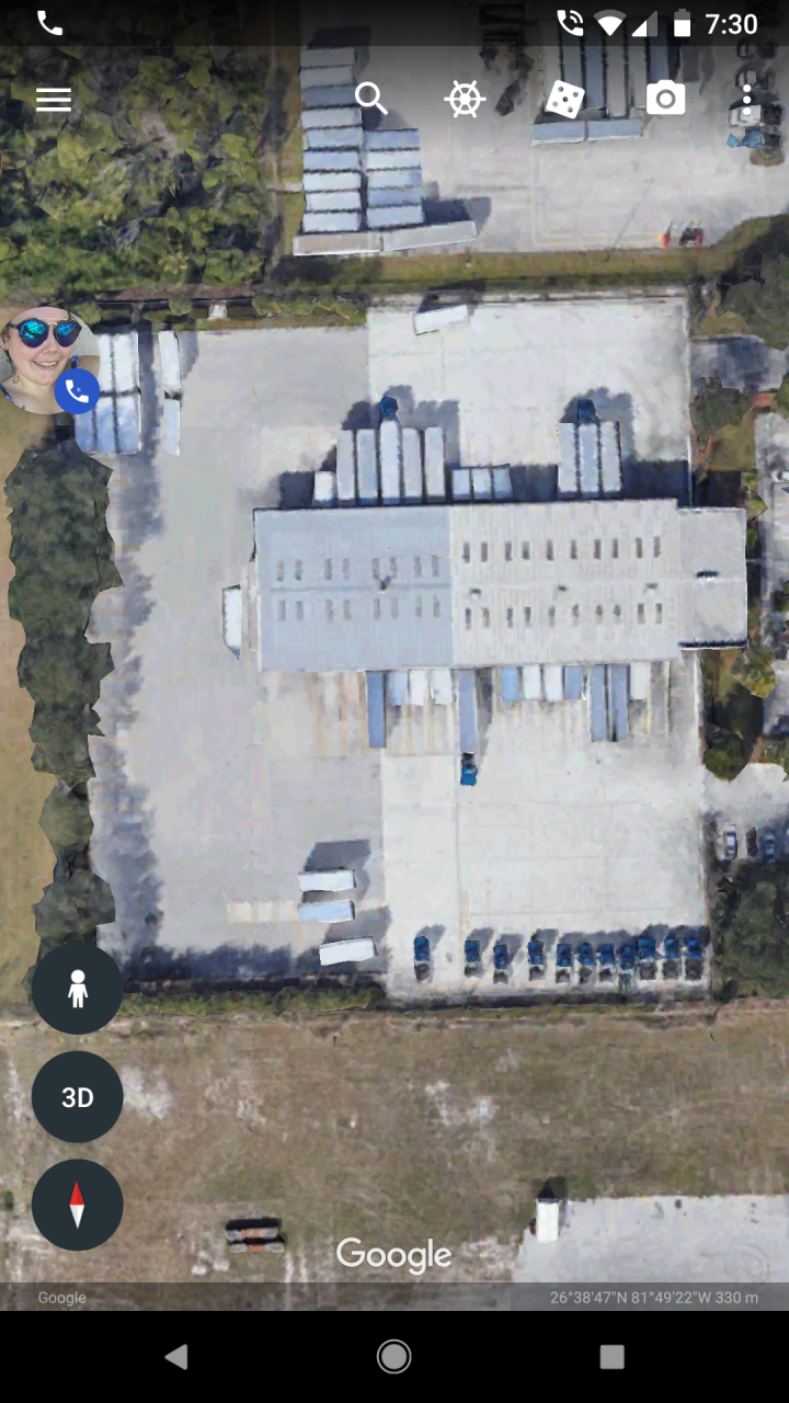

I'm a green horn in the LTL business, and im struggling to throw my truck in areas its honestly not meant to be. Anyone know of any good YouTube clips, or anything in regards to blind backing? I found a couple, but the videos always have like an acre to do there manuever.
For example, my terminal was built way before 53ft trailers were legal and sometimes I have to park between two trailers and I HAVE to blind side. Tips of set ups or anything I'd appreciate
Anyone have any tips for blind siding?

The truck on the upper left corner is where I sometimes have to park. The satellite image looks like there's more room but the area before the grass is like a concrete wall.
You can only enter from the entrance next to the bobtail trucks -

Use your small concave mirror to visualize your tires. Put your tires where they need to go. Try to use the tire marks left by other drivers to guide your path. Stop, get out of the truck and assess your truck's orientation, then visualize how you're going to continue the movement to put it where it needs to be.
Today, I had to blind side a 53' trailer into a dock next to another trailer to the right of it. There was not enough space for the tractor to align straight with the trailer once it hit the dock, so the trailer had to hit the dock square with the tractor at a roughly 45 degree angle to the trailer. The slope of the ramp didn't help much; the pivot point of the tandems was constantly changing throughout the move. Sliding the tandems all the way to the rear made it easier to compensate for that. Lots of getting out to re-assess, then making small adjustments to get it all in the right place. Took about 30 minutes to get it done.
The trailer on the right in the satellite view below is the spot that mine went into. Note the lack of space to the front of the trailers.
