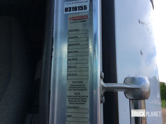

    Isn’t your rear end ratio on a metal plate in the driver’s door jam....?
    Plus watch your overall height pulling a 13’6” trailer.
    Farmerbob1 Thanks this.

    I'm on home time. Truck's in the shop for some routine maintenance and dealing with a few little things. I have never had a need to look for the rear end ratio. I drove the truck as an employee, and nothing changed when I bought it.
    That said, knowing where to look for rear end ratio will be useful for when I buy a different truck though, Thanks!
