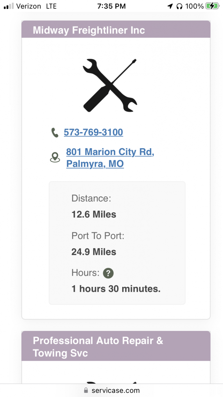

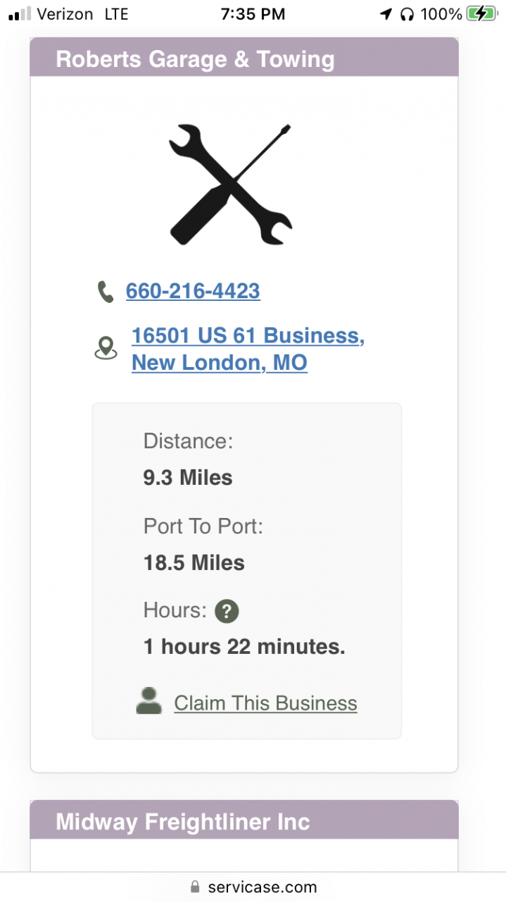

    Ill put that website in my quiver, but id really rather weld it myself, ive been burned too many times by others shoddy overpriced work
