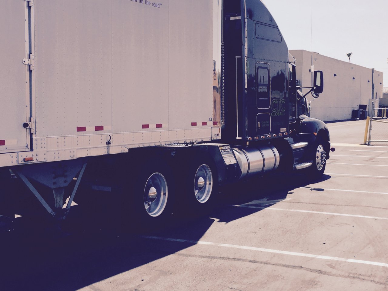

    I have a 2012 Kenworth T-660 studio sleeper, had to remove the fairing and steps on passenger side to get the APU on, didn't look good, but wanted to save money on fuel and less wear and tear on the engine with idling. image.jpeg

    To make it look clean, buy the side skirt with the end cap and install that instead of the one you have that is used with the matching steps

    Yes your right about the end cap, but it costs like $1100, and still would have to get it painted. So I skipped it.
