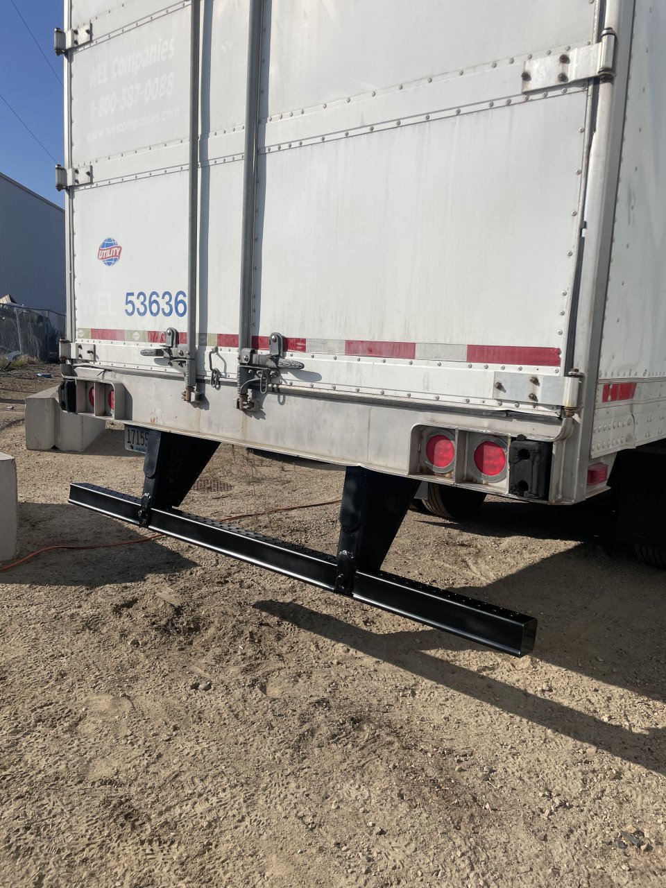

Are 2 zinc 3/4 bolts strong enough to hold ICC/DOT bumper/tube?

    1 - the coatings on the bolt have nothing to do with the strength of the bolt. Be it zinc-plated, zinc-coated, cold galvanized or hot galvanized coating, the coating won't diminish the tensile strength or diminish the shear strength.
    2 - Anodizing is a process of sealing aluminum surfaces. You are thinking about what is commonly called the Blacking or black oxidizing process.
    That said the ICC bumper and its components are to withstand a 20,000 lb force. Given that many of these bumpers use a minimum of four bolts to hold it onto the frame/body of the truck, Grade 2 bolts can be used, Grade 5 is better, and of course, Grade 8 is the best. Failure of the bumper, and the doubt that any of the inspection officers have any clear knowledge of what the differences are, I would say you are safe in using grade 2 bolts.

    Im never replacing an icc tube again, especially 1 that is 15 years old looks like, the old bolts became a part of the bracket, had to cut the old tube, drill holes for the new tube, took me a whole day since I didnt have the right tools. so I wanted to do it right - grade 8 bolts it was. that thing aint going anywhere (wish i had a before pic)
