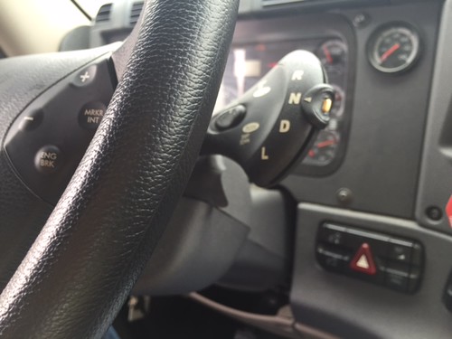

    13 speed Eaton. This is the fourth time we've had the unit in for intermittent loss of communication to the TCU. I've driven this thing a few hundred miles in the last few weeks and haven't been able to get it to act up. But it has logged faults from it. Freightliner had us replace TCU, X-Y shifter, CPC, ect... Now they wanted us to tear apart the OEM harness and see if we can find the cause of the 1939 problems. This truck is very odd though, I unplugged a J1939 terminating resistor while driving down the interstate and it didn't skip a beat or log a single fault.
    Outside OEM harness.
