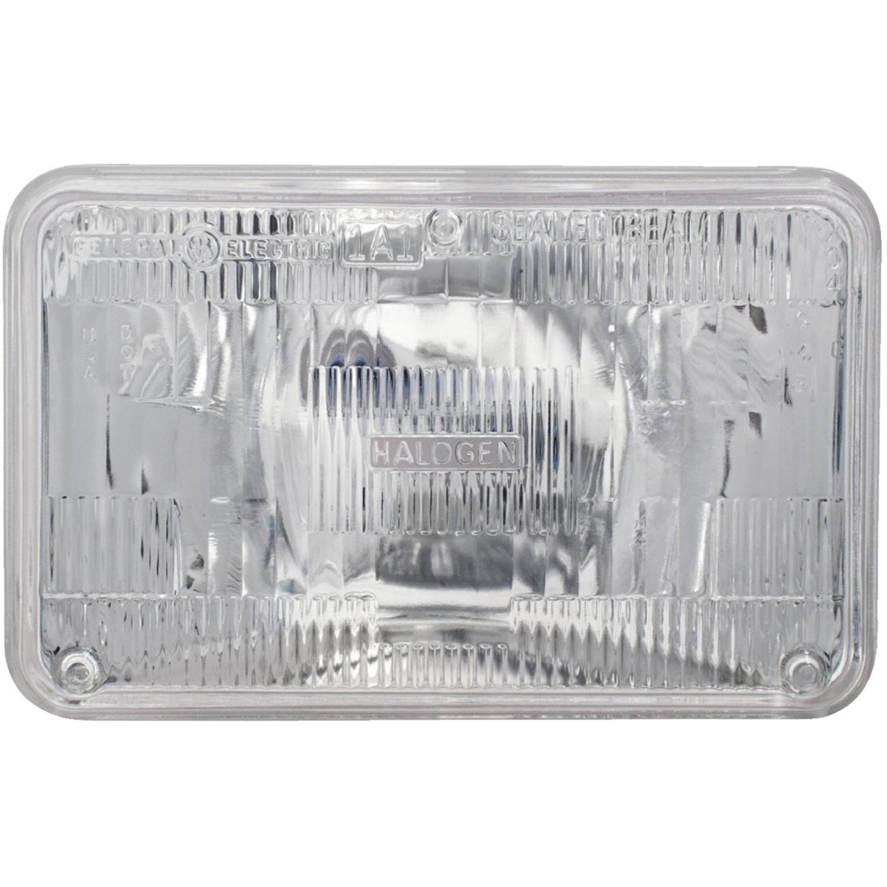

    I checked into getting a set of 2023 579 Headlight but they are not a direct fit into my 2018 579. Was kinda bummed out but whatever. I was out in Wyoming last week in the blizzard and had a light go out. So I parked and grabbed my spare from the bunk and started installing it. A prime flatbed driver came up to me and offered me these bulbs he bought off Amazon and had ordered an extra set. He would not take no as an answer. Refused to even take some cash. They were Led bulbs. I’ll post picture of them. They made 10000x difference. Night and day difference. I’ll order some to have as spare and maybe somebody might need them like I did.

    I’ve got a set of halogens coming, this next week or so. I’m concerned about the low-beam wattage. But, I just want to try something. Another concern is lifespan. I know these whiter bulbs don’t last as long. But, IF they do work out, then, they could be a nice upgrade, without the risks of an LED in a halogen housing.

    The guy that gave me these said he had them in his truck for little over a year without replacing. When I switch to high beams I get a light on saying high beam bulb needs replaced even though it’s functioning properly and it only stays on for maybe 30 seconds before going away . Sometimes it doesn’t do it. Sometimes it does. Weird

    Update: Truck is a ‘20 T680 with projector low-beams. I have had these installed in my low-beam position, the last 5 days. Even though they say they’re 75W, I believe the blue colored coating on the glass is blocking the entire 75W worth of lumens from getting out. They’re only marginally brighter and certainly not anywhere close to as bright as my 60W high-beams. They say “up to 5500K” for their color. They’re actually more blue than that, IMO. As we know, the more blue, the less effective as a light source. I ended up adjusting them further down, to put more beam on the ground. The color just takes away too much of their effectiveness. I was beside a Cascadia with factory LED’s and I’d guesstimate my headlights were ~80% of those. I don’t want to say I’m dissatisfied, because they are better. I just wish the color was further down the Kelvin scale. I’m going leave them installed and casually keep looking.
